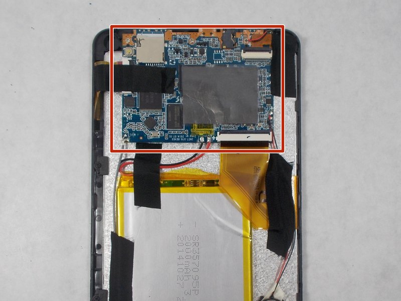

    1. JLab Pro-7 Motherboard Replacement, Motherboard: step 6, image 1 of 1
      • Once the back has been taken off you will find the motherboard at the top of the rear panel of your tablet.
      • The red box shows where your motherboard is
