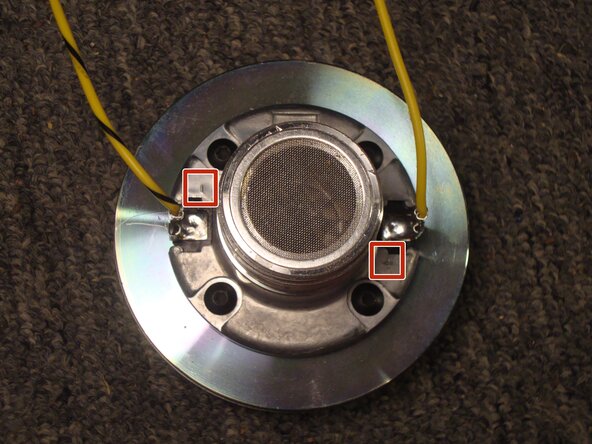

    6. JBL Speaker Tweeter Replacement: step 6, image 1 of 3 JBL Speaker Tweeter Replacement: step 6, image 2 of 3 JBL Speaker Tweeter Replacement: step 6, image 3 of 3
      • The driver has two colored wires: one solid and one striped. The striped wire is attached to the NEGATIVE (-) terminal on the driver. The solid wire attaches to the POSITIVE (+) terminal.
      Ask FixBot

    8. JBL Speaker Tweeter Replacement: step 8, image 1 of 3 JBL Speaker Tweeter Replacement: step 8, image 2 of 3 JBL Speaker Tweeter Replacement: step 8, image 3 of 3
      • Place one multimeter probe on each solder tab of the metal tweeter terminal, with one probe on each tab.
      • Unlike the connection wires, it is not important which multimeter tester goes where.
      • Turn your multimeter to read resistance and test the tweeter.
      • A reading between 4-8 OHMS means functional. A reading below -0 indicates an issue, as this means nothing is being picked up by the meter.
      • An ohm, symbol: Ω is the standard unit of electrical resistance. If your meter is like the example and has specific numbers, the ohm range 2k / 20k / 200k is best for testing general electronics. 2k works perfectly fine for this speaker.
      • If the tweeter is no longer functional, it will need to be replaced.
