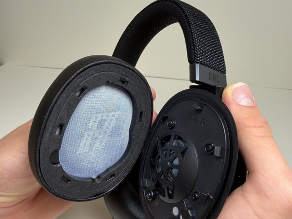

  1. JBL Live 660NC Earpads Replacement, Earpads: step 1, image 1 of 1
    • Slide the opening tool into the seam between the earpad and earcup.
    • Pry it slightly toward the headphone, then angle the tool upward to release the clip.
    • You may hear a small click when the clips release.
    • Be careful not to break the plastic clips.
  2. JBL Live 660NC Earpads Replacement: step 2, image 1 of 1
    • Remove the old earpads from the headphones.
