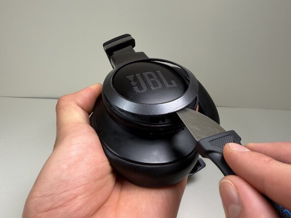

  1. JBL Live 660NC Battery Replacement, Battery: step 1, image 1 of 3 JBL Live 660NC Battery Replacement, Battery: step 1, image 2 of 3 JBL Live 660NC Battery Replacement, Battery: step 1, image 3 of 3
    • The battery is located in the left earcup. All steps in this guide must be performed on the left earcup.
    • Use a Jimmy or spudger to pry the bezel around the JBL plate.
    • Gently slide the tool around the edges to loosen the clips.
    • Lift the bezel off.

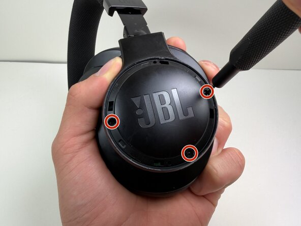

  2. JBL Live 660NC Battery Replacement: step 2, image 1 of 1
    • Remove the three 5 mm screws with a Phillips #00 screwdriver.

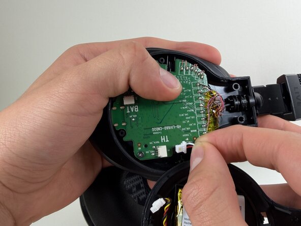

  5. JBL Live 660NC Battery Replacement: step 5, image 1 of 2 JBL Live 660NC Battery Replacement: step 5, image 2 of 2
    • Use a spudger to push the connector labeled BAT from the socket on the motherboard to disconnect the battery cable
    • Don’t pull on the wires—this can damage the connector and the device.

  6. JBL Live 660NC Battery Replacement: step 6, image 1 of 2 JBL Live 660NC Battery Replacement: step 6, image 2 of 2
    • Use the tip of the spudger to push the plastic locking tab away from the socket labeled TH—it should only move about 1–2 mm.
    • Carefully remove the cable connector from the socket on the board.
    • Avoid pulling on the wires, and don’t twist or bend them.
