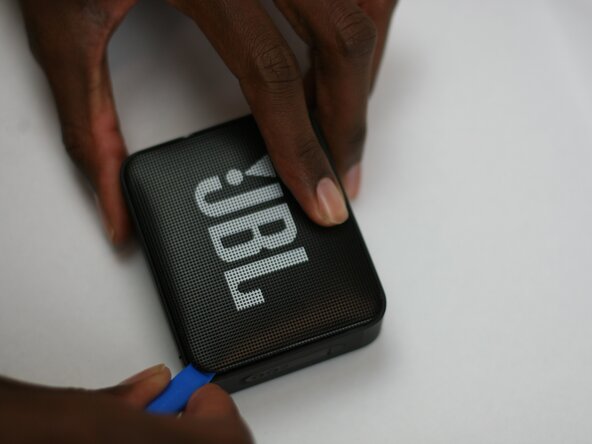

  2. JBL Go 2 Speaker Grille Replacement: step 2, image 1 of 1
    • Start at a corner and look closely at the edge of the front grille.
    • Insert a plastic pry tool into the seam between the grille and the rubber body.
    Ask FixBot

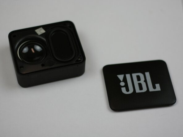

  3. JBL Go 2 Speaker Grille Replacement: step 3, image 1 of 1
    • Move along the edges, popping clips one by one to ensure no cracking.
    • Separate the grille from the speaker housing; it should come off easily.
