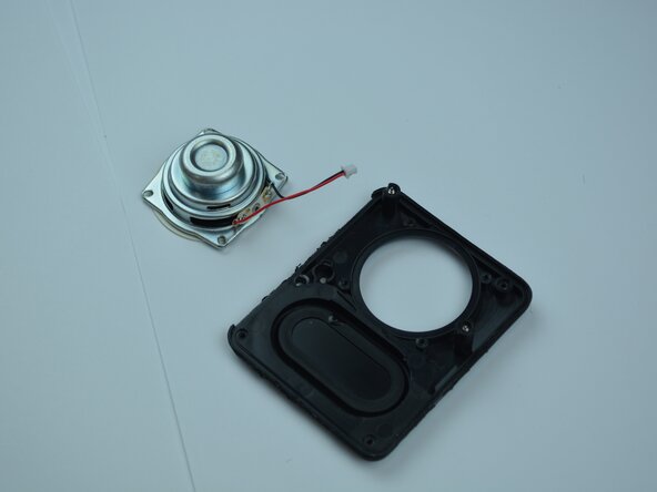

    4. JBL Go 2 Driver Replacement: step 4, image 1 of 2 JBL Go 2 Driver Replacement: step 4, image 2 of 2
      • Disconnect the driver connector.
      Ask FixBot
    5. JBL Go 2 Driver Replacement: step 5, image 1 of 2 JBL Go 2 Driver Replacement: step 5, image 2 of 2
      • Remove the four 9 mm screws that secure the driver.
      Ask FixBot
    6. JBL Go 2 Driver Replacement: step 6, image 1 of 2 JBL Go 2 Driver Replacement: step 6, image 2 of 2
      • Make sure the internal wires are disconnected.
      • Gently pry the driver out of its assembly.
      Ask FixBot
