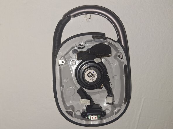

    1. JBL Clip 4 Speaker Driver Replacement, Speaker Driver: step 7, image 1 of 1
      • The component in the middle is the speaker driver, its cable will be disconnected already since it was required to disconnect the back housing, so you just need to flip this part over.

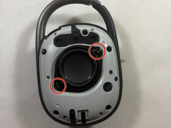

    2. JBL Clip 4 Speaker Driver Replacement: step 8, image 1 of 1
      • Now, with the device flipped, you need to unscrew these two 5mm screws that connect the front housing and the speaker driver together.
      Ask FixBot
    3. JBL Clip 4 Speaker Driver Replacement: step 9, image 1 of 1
      • Now the speaker driver should just come right out of the device.
