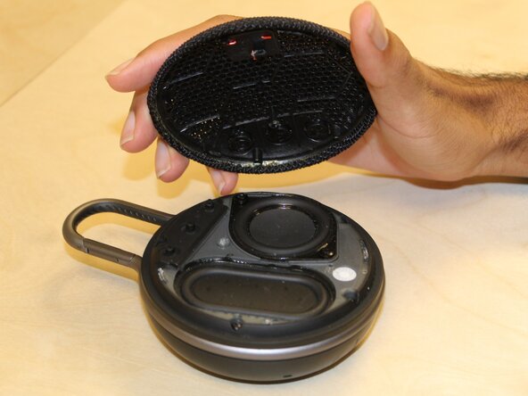

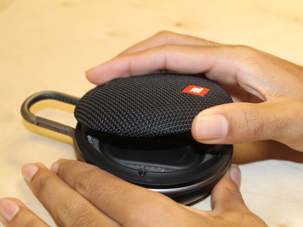

    • Unplug the speaker from any power source and power it off.
    • Gently pry the plastic front cover away from the device face using your hands or a flat tool and set it aside.

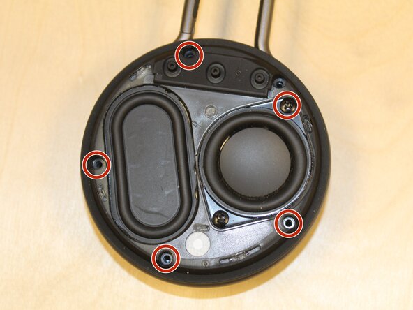

  2. JBL Clip 3 Micro-USB Charging Port Replacement: step 2, image 1 of 2 JBL Clip 3 Micro-USB Charging Port Replacement: step 2, image 2 of 2
    • Using a Phillips #0 screwdriver, remove the five outermost screws from the speaker.

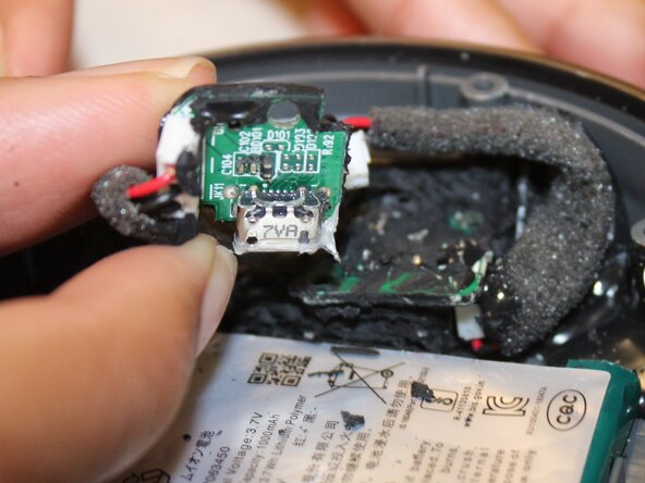

  3. JBL Clip 3 Micro-USB Charging Port Replacement: step 3, image 1 of 3 JBL Clip 3 Micro-USB Charging Port Replacement: step 3, image 2 of 3 JBL Clip 3 Micro-USB Charging Port Replacement: step 3, image 3 of 3
    • Flip the speaker piece back to set it aside from the main device.
    • A wire will still be connected to the motherboard. Make sure to gently open the speaker up to avoid severing connections.

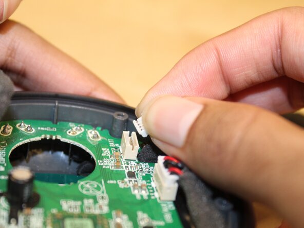

  4. JBL Clip 3 Micro-USB Charging Port Replacement: step 4, image 1 of 3 JBL Clip 3 Micro-USB Charging Port Replacement: step 4, image 2 of 3 JBL Clip 3 Micro-USB Charging Port Replacement: step 4, image 3 of 3
    • Unplug the wire connectors (the black and red wires with the white head) by pulling the connector head from its housing on the motherboard.

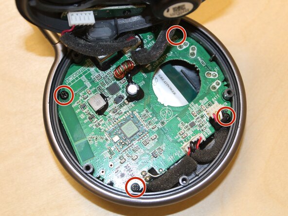

  5. JBL Clip 3 Micro-USB Charging Port Replacement: step 5, image 1 of 3 JBL Clip 3 Micro-USB Charging Port Replacement: step 5, image 2 of 3 JBL Clip 3 Micro-USB Charging Port Replacement: step 5, image 3 of 3
    • Remove the four screws holding the motherboard in place using a Phillips #0 screwdriver.

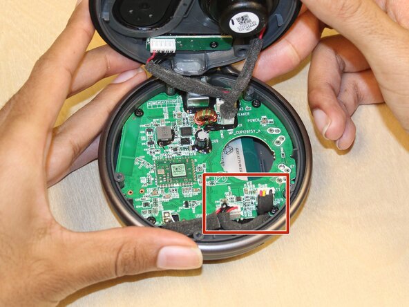

  6. JBL Clip 3 Micro-USB Charging Port Replacement: step 6, image 1 of 3 JBL Clip 3 Micro-USB Charging Port Replacement: step 6, image 2 of 3 JBL Clip 3 Micro-USB Charging Port Replacement: step 6, image 3 of 3
    • Gently remove and set aside the motherboard.
    • Make sure the microphone wire stays connected to the motherboard and the back piece of the device at all times.

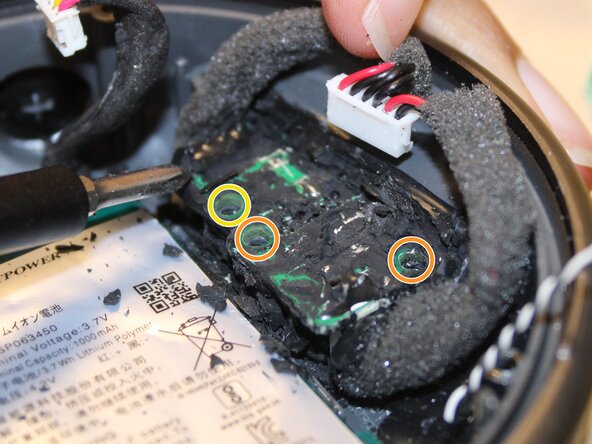

  7. JBL Clip 3 Micro-USB Charging Port Replacement: step 7, image 1 of 3 JBL Clip 3 Micro-USB Charging Port Replacement: step 7, image 2 of 3 JBL Clip 3 Micro-USB Charging Port Replacement: step 7, image 3 of 3
    • If an epoxy seal is present on the printed circuit board (PCB), carefully remove it. It can be peeled off, and it may help to remove the screws first.
    • Removal of the epoxy seal may affect the waterproof feature of the device.
    • Damage to the lithium-ion battery may cause a fire. Do not use a sharp object near the battery.
    • Remove the three screws holding the PCB in place using a Phillips #0 screwdriver.
    • The PCB is in two parts.
    • The only screw holding the micro-USB side down is the leftmost screw.
    Ask FixBot
  8. JBL Clip 3 Micro-USB Charging Port Replacement: step 8, image 1 of 3 JBL Clip 3 Micro-USB Charging Port Replacement: step 8, image 2 of 3 JBL Clip 3 Micro-USB Charging Port Replacement: step 8, image 3 of 3
    • Remove the PCB, ensuring that there are no other connections with the device.
