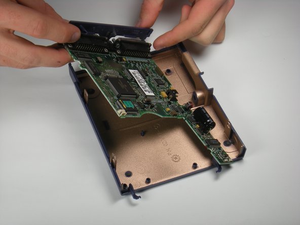

  12. Iomega Z100S2 Motherboard Replacement, Motherboard: step 12, image 1 of 2 Iomega Z100S2 Motherboard Replacement, Motherboard: step 12, image 2 of 2
    • Use a T6 Torx Screwdriver to remove the 1.3 mm screw at the back of the motherboard.
    Ask FixBot
  13. Iomega Z100S2 Motherboard Replacement: step 13, image 1 of 2 Iomega Z100S2 Motherboard Replacement: step 13, image 2 of 2
    • Gently lift the motherboard and back case out from the bottom case.
    Ask FixBot
