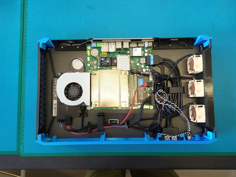

This guide explains how to assemble an Infinity PC: mounting the chassis and Kontron motherboard into the housing, installing the CPU and heat sink, wiring the button board, LED, and cooling fans, and then adding the SSD and Wi-Fi card.

    26. Infinity PC build, Connecting the cooling fan cables: step 26, image 1 of 3 Infinity PC build, Connecting the cooling fan cables: step 26, image 2 of 3 Infinity PC build, Connecting the cooling fan cables: step 26, image 3 of 3
      • Connect the various cooling fans (see schematics).
      • Hook the various cables into the cable clips.
      Ask FixBot

    31. Infinity PC build, It's finished!!: step 31, image 1 of 1
      • On to the next one, or… a coffee.
