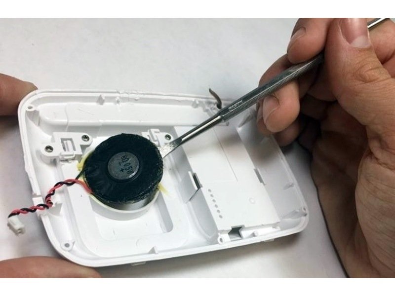

    1. Infant Optics DXR-8 Speaker Replacement, Speaker: step 4, image 1 of 1
      • Use a heat gun to soften and easily remove epoxy that surrounds the speaker. Gently scrape it free little by little with metal spudger.
      Ask FixBot
    2. Infant Optics DXR-8 Speaker Replacement: step 5, image 1 of 1
      • Lift the speaker from casing using metal spudger.
      • Place new 8W speaker in the casing and connect wire.

8W Speaker is incorrect.
The speaker needed is 8 Ohm 0.5 Watt.
Ryan Ernde - Reply Share

This is good to show how you get it open. Unless you have a speaker that has the plastic piece that connects to the mother board, then it’s useless. The speaker I ordered just had two free standing wires.
