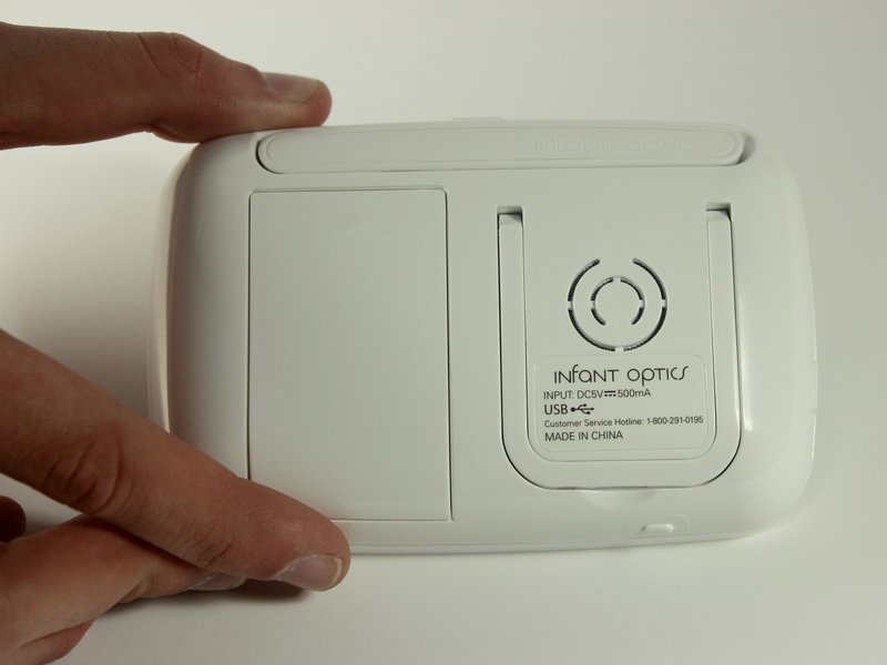

There are no tools required to replace the battery. The most difficult part of replacement is plugging the battery into the battery port. The plug is very small and might be hard to see.
    1. Infant Optics DXR-8 Battery  Replacement, Battery: step 1, image 1 of 3 Infant Optics DXR-8 Battery  Replacement, Battery: step 1, image 2 of 3 Infant Optics DXR-8 Battery  Replacement, Battery: step 1, image 3 of 3
      • Begin by holding the Monitor so that the backside is flipped up. This is where your battery is located.
      • Slide the battery panel downwards to detach it completely. The battery should be completely visible.
