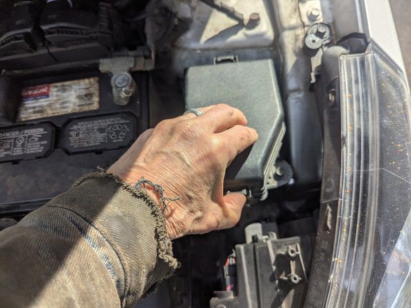

    • Facing the front of the car, the underhood fuse box is located on the right hand side, between the battery and the fender.
    Ask FixBot
  2. Hyundai Accent Fuel Pump Replacement, Open the fuse box: step 2, image 1 of 2 Hyundai Accent Fuel Pump Replacement, Open the fuse box: step 2, image 2 of 2
    • Press the tab on the front of the fuse box.
    • And release the tab on the rear side of the fuse box.

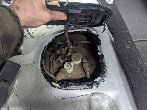

  11. Hyundai Accent Fuel Pump Replacement, Remove the fuel pump access cover: step 11, image 1 of 3 Hyundai Accent Fuel Pump Replacement, Remove the fuel pump access cover: step 11, image 2 of 3 Hyundai Accent Fuel Pump Replacement, Remove the fuel pump access cover: step 11, image 3 of 3
    • Once the seat has been removed, the access cover can be seen. It is secured with putty.
    • Go around the edges of the cover with a putty knife, separating the cover from the floor panel.

  12. Hyundai Accent Fuel Pump Replacement: step 12, image 1 of 2 Hyundai Accent Fuel Pump Replacement: step 12, image 2 of 2
    • Once the majority of the adhesive has been released, pry the cover off, being mindful of the wires still attached through the hole in the center of the cover.

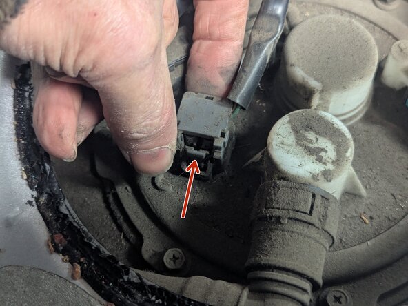

  13. Hyundai Accent Fuel Pump Replacement, Unplug the fuel pump/gauge connector: step 13, image 1 of 2 Hyundai Accent Fuel Pump Replacement, Unplug the fuel pump/gauge connector: step 13, image 2 of 2
    • Squeeze the locking tab and pull up to disconnect the plug that carries the fuel pump power and fuel sender wires.

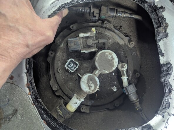

  18. Hyundai Accent Fuel Pump Replacement, Disconnect the main fuel line: step 18, image 1 of 3 Hyundai Accent Fuel Pump Replacement, Disconnect the main fuel line: step 18, image 2 of 3 Hyundai Accent Fuel Pump Replacement, Disconnect the main fuel line: step 18, image 3 of 3
    • Squeeze the tabs on the top and bottom of the main fuel line connector to release it.
    • Slide the connector off the nipple.
    Ask FixBot
  19. Hyundai Accent Fuel Pump Replacement: step 19, image 1 of 3 Hyundai Accent Fuel Pump Replacement: step 19, image 2 of 3 Hyundai Accent Fuel Pump Replacement: step 19, image 3 of 3
    • Unscrew the eight mounting screws using an 8 mm socket or nut driver.

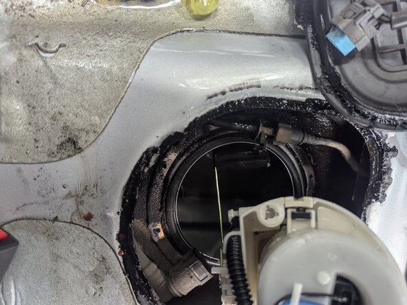

  21. Hyundai Accent Fuel Pump Replacement, Remove the pump from the fuel tank: step 21, image 1 of 3 Hyundai Accent Fuel Pump Replacement, Remove the pump from the fuel tank: step 21, image 2 of 3 Hyundai Accent Fuel Pump Replacement, Remove the pump from the fuel tank: step 21, image 3 of 3
    • The pump has some odd offsets and angles, so you'll have to do some fiddling with the pump to get it out. First, lift it up and slide it to the side to position the main body within the opening.
    • Next, lift it straight up, being mindful that it is a container and still holds a quantity of gasoline.
    • Be careful of the fuel sender float at the bottom of the pump assembly; you'll have to offset the pump again to get it out without damage.
