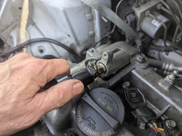

  4. Hyundai Accent CVVT Oil Control Valve Replacement, Unplug the oil control valve electrical connector: step 4, image 1 of 3 Hyundai Accent CVVT Oil Control Valve Replacement, Unplug the oil control valve electrical connector: step 4, image 2 of 3 Hyundai Accent CVVT Oil Control Valve Replacement, Unplug the oil control valve electrical connector: step 4, image 3 of 3
    • Press the tab on the electrical connector and unplug the OCV.

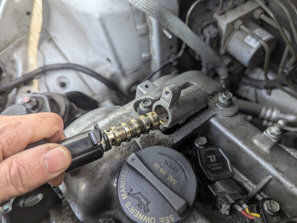

  6. Hyundai Accent CVVT Oil Control Valve Replacement, Remove the oil control valve: step 6, image 1 of 3 Hyundai Accent CVVT Oil Control Valve Replacement, Remove the oil control valve: step 6, image 2 of 3 Hyundai Accent CVVT Oil Control Valve Replacement, Remove the oil control valve: step 6, image 3 of 3
    • Grasp the OCV and with a twisting motion, pull the valve out of its housing.

  7. Hyundai Accent CVVT Oil Control Valve Replacement: step 7, image 1 of 1
    • The oil control valve has been removed.
