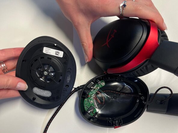

    1. HyperX Cloud III Motherboard Replacement, Motherboard: step 2, image 1 of 2 HyperX Cloud III Motherboard Replacement, Motherboard: step 2, image 2 of 2
      • Use a Phillips #2 screwdriver to remove the four 9.4 mm-long screws securing the speaker plate to the earphone.
      • Use your fingers to pull and remove the black speaker plate.

    2. HyperX Cloud III Motherboard Replacement: step 3, image 1 of 2 HyperX Cloud III Motherboard Replacement: step 3, image 2 of 2
      • Use a Phillips #2 screwdriver to remove the two 6.7 mm-long screws securing the motherboard.

    3. HyperX Cloud III Motherboard Replacement: step 4, image 1 of 2 HyperX Cloud III Motherboard Replacement: step 4, image 2 of 2
      • Use a soldering iron to desolder the connecting cable wires from the motherboard.
      • Use tweezers to turn the motherboard backward, to desolder the connecting cables wires on this side.
