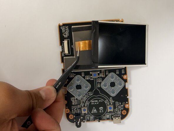

    3. Hyper Mega Tech! Taito Super Pocket Screen Replacement: step 11, image 1 of 3 Hyper Mega Tech! Taito Super Pocket Screen Replacement: step 11, image 2 of 3 Hyper Mega Tech! Taito Super Pocket Screen Replacement: step 11, image 3 of 3
      • With the screen hinged open, disconnect the ribbon cable connector from the PCB.
      • Carefully lift the screen away from the PCB using tweezers.
