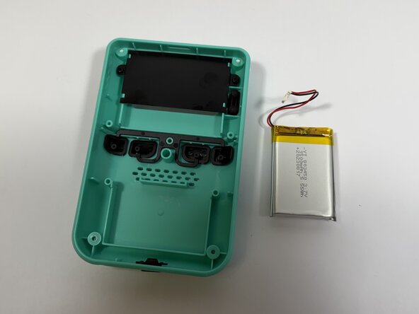

  5. Hyper Mega Tech! Taito Super Pocket Battery Replacement: step 5, image 1 of 1
    • Disconnect the battery cord connecting the two sides with tweezers.
    Ask FixBot
  6. Hyper Mega Tech! Taito Super Pocket Battery Replacement, Battery: step 6, image 1 of 2 Hyper Mega Tech! Taito Super Pocket Battery Replacement, Battery: step 6, image 2 of 2
    • Use an iFixit opening tool to separate the battery from the adhesive.
    • Carefully remove the battery from the device.
