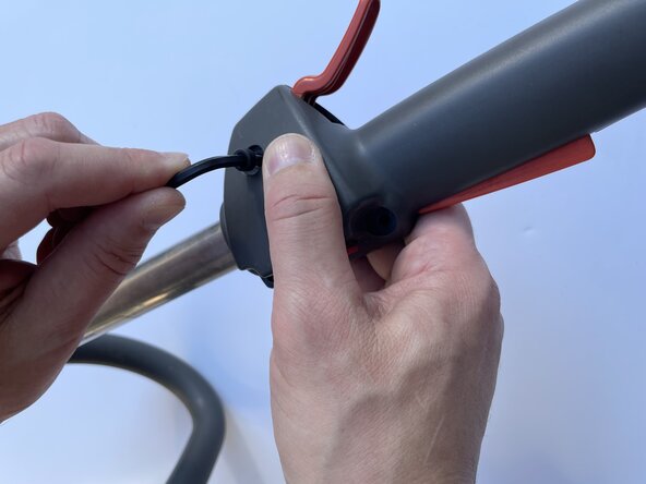

    • Disconnect the spark plug.
    • Make sure to twist the cap and rest it on the side of the spark plug (as seen in the second image) to avoid potentially starting the string trimmer while you complete the replacement.

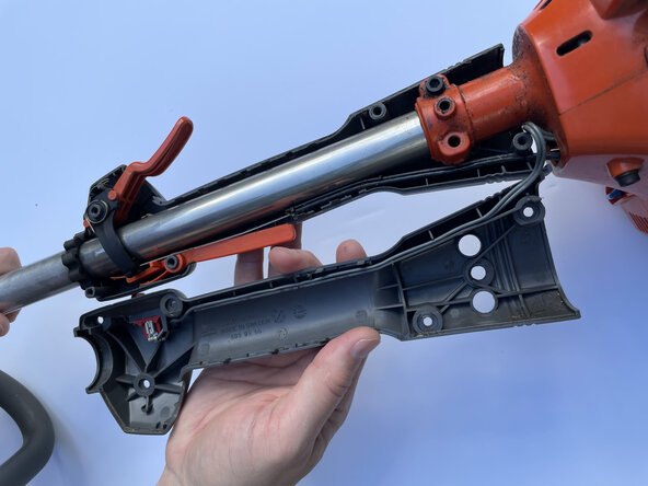

    • Using your 4 mm Allen wrench, remove the five 4x18 mm hex cap screws, one 5x14 mm button head hex cap screw, and the 8x16 mm O-Ring under the button head screw from the plastic housing.
    • Remove the plastic housing.

    • Remove the wire from the wire guide on the interior of the plastic housing.
    Ask FixBot

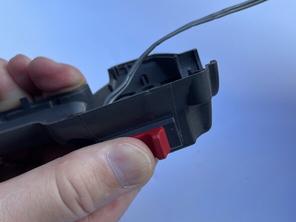

    • Using a spudger, pry the failed stop switch out of the plastic housing.
    • The switch is tightly secured, so you will likely need something small to help you pry it out.

    • Pull the electrical wires off of both sides of the stop switch.
    • Pay attention to which wire connects to which side of the switch, as you will connect the wires to your new switch in the next step.
