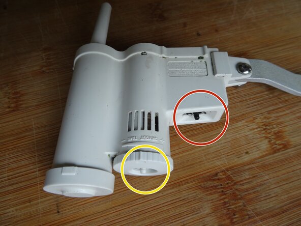

Hunter Rain Clik cap and spindle assembly replacement
    1. Hunter Rain Clik cap and spindle assembly replacement, Hunter Rain Clik cap and spindle assembly: step 1, image 1 of 2 Hunter Rain Clik cap and spindle assembly replacement, Hunter Rain Clik cap and spindle assembly: step 1, image 2 of 2
      • Figure 2 shows the wireless version installed in the garden.
      • It's much easier to work if you remove the entire sensor.

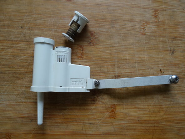

    2. Hunter Rain Clik cap and spindle assembly replacement: step 2, image 1 of 2 Hunter Rain Clik cap and spindle assembly replacement: step 2, image 2 of 2
      • Use your fingernail to lift the disc assembly.
      • Take out the assembly.
      • Figure 2 shows the old insert and the replacement part.

    3. Hunter Rain Clik cap and spindle assembly replacement: step 3, image 1 of 2 Hunter Rain Clik cap and spindle assembly replacement: step 3, image 2 of 2
      • The discs are badly rotted, and insects have infested the inside.

    4. Hunter Rain Clik cap and spindle assembly replacement: step 4, image 1 of 3 Hunter Rain Clik cap and spindle assembly replacement: step 4, image 2 of 3 Hunter Rain Clik cap and spindle assembly replacement: step 4, image 3 of 3
      • Using a toothpick and a cotton swab thoroughly clean the insides. There was a lot of dirt in there — no wonder the sensor stopped working.
      • Keep an eye on the spring. Don't lose it. Put it back exactly in the middle.

    5. Hunter Rain Clik cap and spindle assembly replacement: step 5, image 1 of 1
      • Push the insert back in. The lid must audibly click into place on both sides and be able to move freely.
      • Turning the lid opens the ventilation slots. Depending on the number of slots that are open, the drying time will be longer or shorter.
      • To test the sensor, press and hold the black button for about 10 seconds. A LED on the bottom of the wireless model should flash, and the control unit should then turn off.
      • You can also pour water into the opening from above, over the discs. Wait a few minutes until the discs have swollen, then the control unit should turn off.
