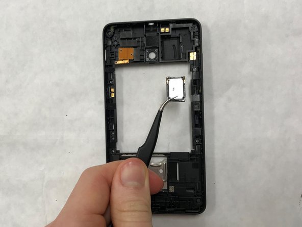

    5. Huawei Y300 Vibrator Replacement: step 5, image 1 of 2 Huawei Y300 Vibrator Replacement: step 5, image 2 of 2
      Tool used on this step:
      Buy
      • Use the tweezers to remove the vibrator from the device.
