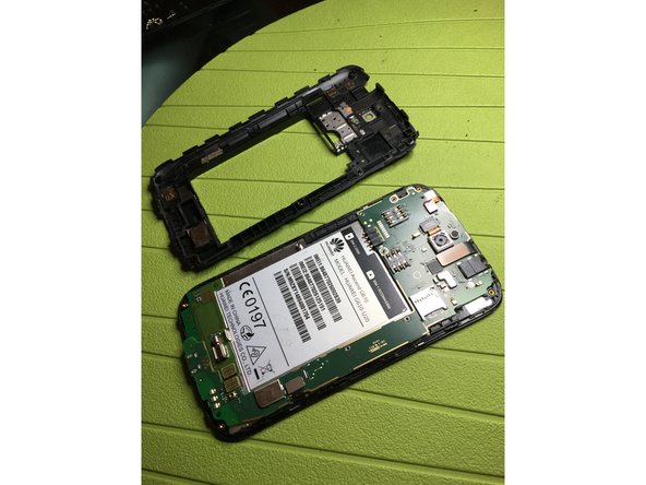

    4. Huawei Ascend G610 Digitizer Replacement: step 4, image 1 of 1
      • With the help of a heat source and a cross-head screwdriver, remove the 9 screws along the sides of the phone . One screw is covered by an adhesive label.
      • Remove the shortest screw that secures the center of the body, located next to the SIM card.
      Ask FixBot
    5. Huawei Ascend G610 Digitizer Replacement: step 5, image 1 of 2 Huawei Ascend G610 Digitizer Replacement: step 5, image 2 of 2
      • With the help of thin tool, unhinge the joints between the outer cover and the internal frame of the display.
      • Remove the outer cover.
