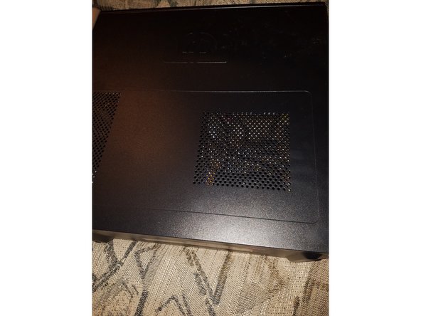

    1. Hp Pavilion A600 Hdd Replacement, Hdd: step 1, image 1 of 2 Hp Pavilion A600 Hdd Replacement, Hdd: step 1, image 2 of 2
      • first take out the Phillips screw out of the side panel and then take off the side panel.

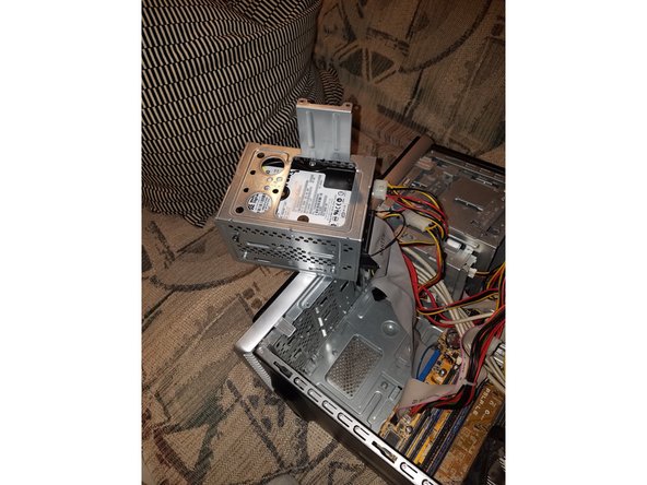

    3. Hp Pavilion A600 Hdd Replacement, Pop out the deck: step 3, image 1 of 3 Hp Pavilion A600 Hdd Replacement, Pop out the deck: step 3, image 2 of 3 Hp Pavilion A600 Hdd Replacement, Pop out the deck: step 3, image 3 of 3
      • Once you've done that then push the button down closer to the logic board right next to it the HDD deck and slide it to the right and pop it out.

    4. Hp Pavilion A600 Hdd Replacement, Taking  the HDD out: step 4, image 1 of 3 Hp Pavilion A600 Hdd Replacement, Taking  the HDD out: step 4, image 2 of 3 Hp Pavilion A600 Hdd Replacement, Taking  the HDD out: step 4, image 3 of 3
      • Unscrew the four screws holding the HDD in then take that unplug it and then take it out of the deck.
