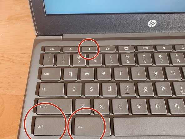

  4. How to install Linux HP Chromebook 11 G8 EE, Enter Dev Shell: step 4, image 1 of 2 How to install Linux HP Chromebook 11 G8 EE, Enter Dev Shell: step 4, image 2 of 2
    • It will take around 5-6 minutes to enter developer mode
    • After you have entered developer mode and returned to the main login screen in ChromeOS, connect to Wi-Fi.
    • When connected, press Control + alt + forward arrow
