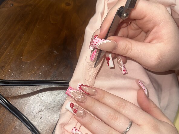

    2. How to Stitch a Ripped Pillowcase Seam: step 2, image 1 of 2 How to Stitch a Ripped Pillowcase Seam: step 2, image 2 of 2
      • Flip the pillow case inside out.
      • Pull out the frayed and ripped threads using tweezers.

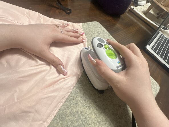

    3. How to Stitch a Ripped Pillowcase Seam: step 3, image 1 of 2 How to Stitch a Ripped Pillowcase Seam: step 3, image 2 of 2
      • Iron the seams flat on top of each other.
      • Be careful to not touch iron with your bare hands, as it is hot.

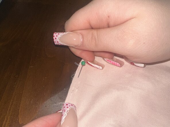

    4. How to Stitch a Ripped Pillowcase Seam: step 4, image 1 of 2 How to Stitch a Ripped Pillowcase Seam: step 4, image 2 of 2
      • Pin the two layers of fabric together so they lay flat.

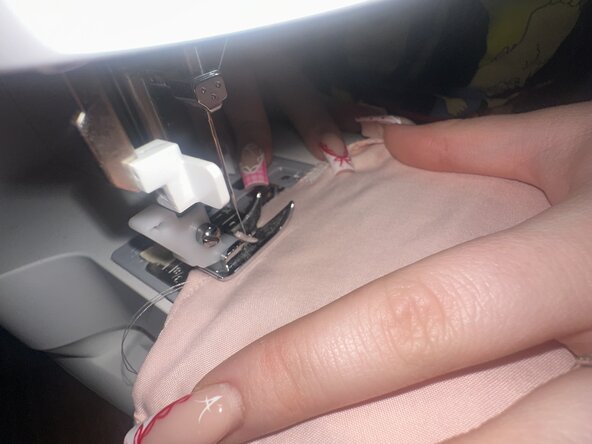

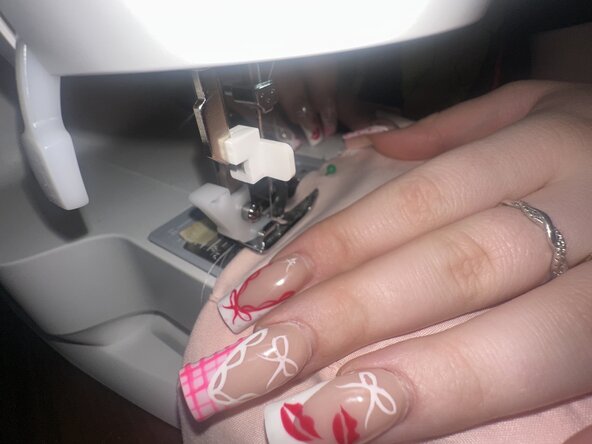

    5. How to Stitch a Ripped Pillowcase Seam: step 5, image 1 of 3 How to Stitch a Ripped Pillowcase Seam: step 5, image 2 of 3 How to Stitch a Ripped Pillowcase Seam: step 5, image 3 of 3
      • Thread the sewing machine with a light colored thread.
      • Sew in a straight line, removing the pin as you get closer to it.
      • Backstitch at the end to knot off the sewing line.
      • Do not put your fingers under the needle when sewing.
