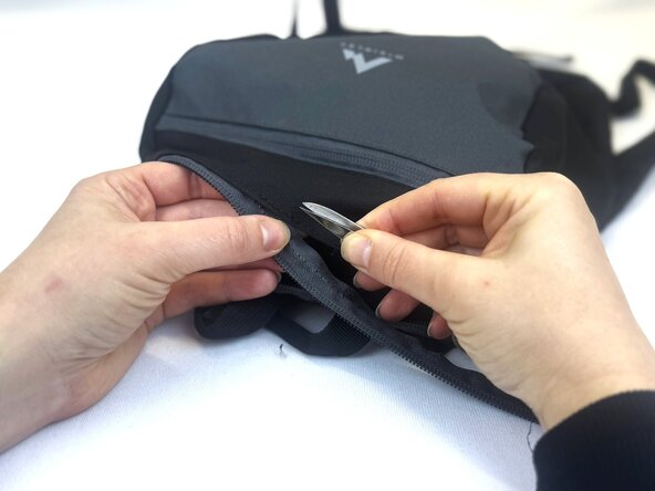

    2. How to Replace the Zipper in a Backpack, Remove the old zipper: step 2, image 1 of 3 How to Replace the Zipper in a Backpack, Remove the old zipper: step 2, image 2 of 3 How to Replace the Zipper in a Backpack, Remove the old zipper: step 2, image 3 of 3
      • Use a pair of scissors to remove the old zipper.
      • Tip: Some zippers may have double‑seam reinforcement, so it might take more time and patience to remove the entire zipper system.

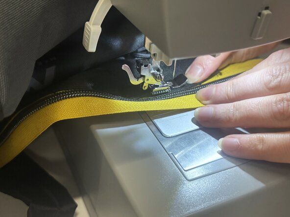

    5. How to Replace the Zipper in a Backpack, Start stitching: step 5, image 1 of 3 How to Replace the Zipper in a Backpack, Start stitching: step 5, image 2 of 3 How to Replace the Zipper in a Backpack, Start stitching: step 5, image 3 of 3
      • Align the new zipper along the seam line and start stitching.
      • Note: This is needed for the "front end" of the zipper. We will show you in the next steps how to do the "back".

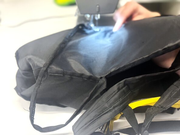

    6. How to Replace the Zipper in a Backpack, Continue stitching: step 6, image 1 of 3 How to Replace the Zipper in a Backpack, Continue stitching: step 6, image 2 of 3 How to Replace the Zipper in a Backpack, Continue stitching: step 6, image 3 of 3
      • Once the front part is done, it is time to turn the bag "inside-out" and align the back part of the "binder" with the zipper.
      • Finish off by closing the binder so that the seam allowance and the zipper tape are both covered at the same time.
      • Note: Because the design before was showing a top stitching, this was kept for the new fix.
      • Remember you now have two seams instead of one.
      • Tip: We recommend reinforcing the seam with a "flat stitching" and for the final stitch to close the gap on the ends of the zipper.

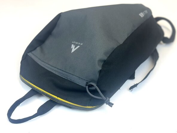

    7. How to Replace the Zipper in a Backpack, Finished and ready!: step 7, image 1 of 1
      • 🛠️🏆👏 Congratulations! The repair is complete, and you're ready to go!
