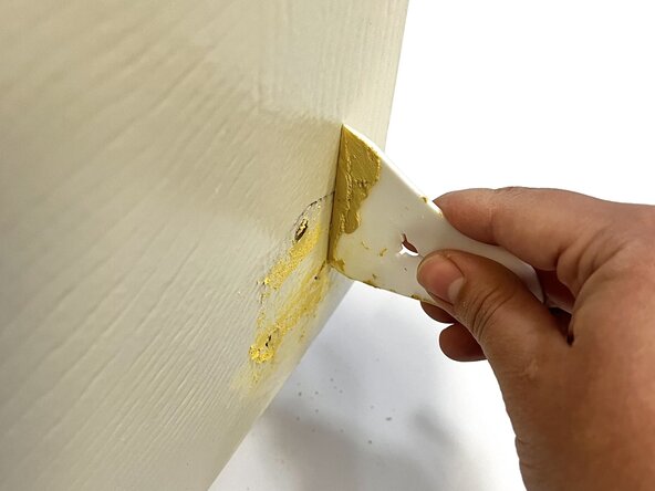

  2. How to Replace a Kick-Down Doorstop: step 2, image 1 of 3 How to Replace a Kick-Down Doorstop: step 2, image 2 of 3 How to Replace a Kick-Down Doorstop: step 2, image 3 of 3
    • Use a plastic putty knife to apply a small amount of wood filler over the old screw holes.
    • Spread the filler in both vertical and horizontal directions until the holes are completely filled.
    • Gently scrape the plastic putty knife over the surface to remove any excess wood filler from the door surface.
    • Let the wood putty set for at least 20 minutes to dry.

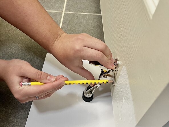

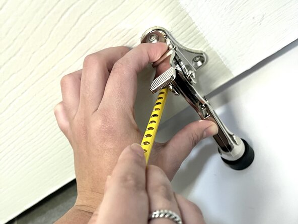

  4. How to Replace a Kick-Down Doorstop: step 4, image 1 of 3 How to Replace a Kick-Down Doorstop: step 4, image 2 of 3 How to Replace a Kick-Down Doorstop: step 4, image 3 of 3
    • Place the new kick-down doorstop against the door.
    • Open the door to about 90 degrees, then adjust it to the position where the doorstop will hold the door securely in the open position.
    • Use a pencil to mark where the screws will be inserted into the door.
