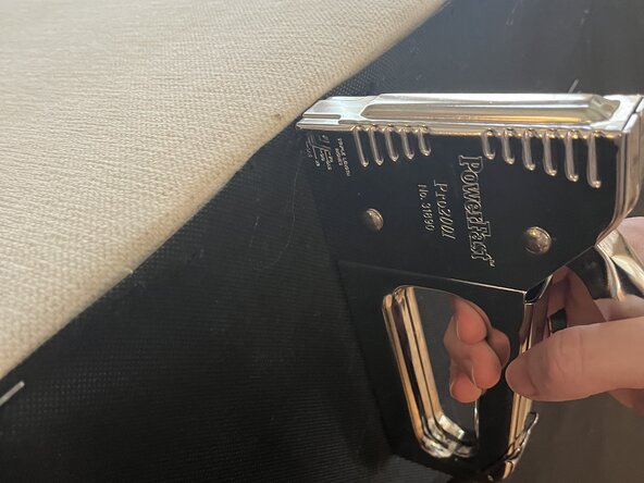

      • Pull the dust cover tight, align it with its original staple holes if possible, then secure it using an upholstery staple gun.
