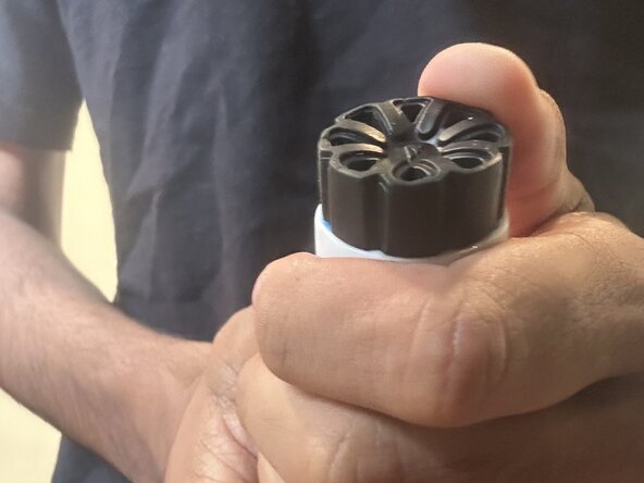

    5. How to Repair a Broken Pool Cue: step 5, image 1 of 2 How to Repair a Broken Pool Cue: step 5, image 2 of 2
      • Place the cue stick in a safe location and let the glue to dry fully based on the manufacturer’s instructions.
      • Do not lean the cue against a wall. This can cause the joint to shift and dry crooked.
      • Choose a spot where the cue will not be bumped or handled. Keep it away from pets, children, or anything that may cause movement.
