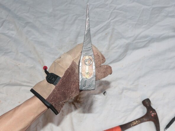

  7. How to Rehandle a Wooden Axe: step 7, image 1 of 1
    • Mark the top of the handle where you'll insert the metal wedges.
    • These wedges will push the wood inside the eye of the axe to the edges and secure the head.
    Ask FixBot
  8. How to Rehandle a Wooden Axe: step 8, image 1 of 2 How to Rehandle a Wooden Axe: step 8, image 2 of 2
    • Lightly tap the metal wedge on the mark you made until it can stand on its own.
    • Hammer the wedge down into the eye and stop once the top of the wedge is flush with the top of the handle.
    • Repeat steps with the second metal wedge.
    • Hammering metal wedges can cause injury; remember to have your gloves and protective glasses equipped.
