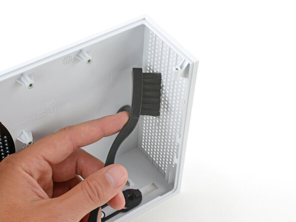

    1. How to Open and Clean an Xbox Series S, Clean the plastic cases: step 7, image 1 of 3 How to Open and Clean an Xbox Series S, Clean the plastic cases: step 7, image 2 of 3 How to Open and Clean an Xbox Series S, Clean the plastic cases: step 7, image 3 of 3
      Tool used on this step:
      Anti-Static Brush
      $2.99
      Buy
      • Over time, dust will build up in the Xbox's plastic cases and their vents.
      • Using a cleaning brush or a new toothbrush, clean any dust out of the vents on the plastic cases.
      • Use a dust blower or light compressed air to blow remaining dust out of the vents.
      • Use a clean rag or microfiber cloth to wipe clean the insides of the plastic cases.
      • If there are any particularly grimy spots, apply a few drops of soapy water or isopropyl alcohol to your cloth to help remove debris.

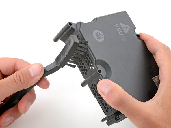

    2. How to Open and Clean an Xbox Series S, Clean the power supply: step 15, image 1 of 2 How to Open and Clean an Xbox Series S, Clean the power supply: step 15, image 2 of 2
      • The fan draws air through the power supply, which can collect dust and dirt.
      • Be careful not to damage the thermal putty on the power supply.
      • Using an anti‑static brush or a new toothbrush, clean any dust out of the vents on the sides of the power supply.
      • Use a dust blower to blow any loose dust out of the power supply and a cloth to wipe the vents clean.
      Ask FixBot

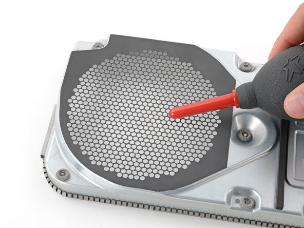

    3. How to Open and Clean an Xbox Series S, Clean the upper chassis: step 16, image 1 of 3 How to Open and Clean an Xbox Series S, Clean the upper chassis: step 16, image 2 of 3 How to Open and Clean an Xbox Series S, Clean the upper chassis: step 16, image 3 of 3
      • Repeat the previous step to clean the fan grill on the top of the chassis.
      Ask FixBot

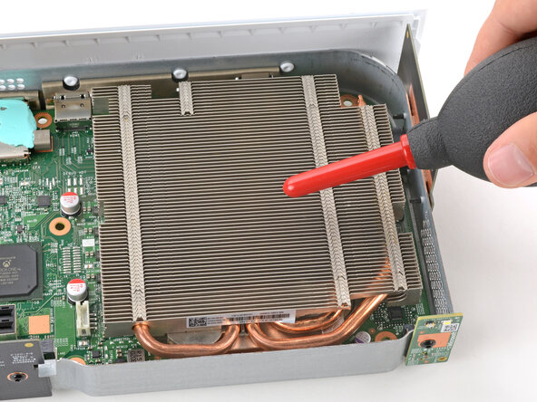

    4. How to Open and Clean an Xbox Series S, Clean the heat sink fins: step 17, image 1 of 3 How to Open and Clean an Xbox Series S, Clean the heat sink fins: step 17, image 2 of 3 How to Open and Clean an Xbox Series S, Clean the heat sink fins: step 17, image 3 of 3
      • The fan draws air through the heatsink's metal fins, which can accumulate dust and dirt over time.
      • Gently slide the bristles of an anti‑static brush or new toothbrush back and forth between the metal fins to loosen any debris.
      • Use a dust blower to blow any loose dust out of the heatsink fins.
      • If you want to clean your Xbox even more thoroughly, follow the remaining steps to remove the motherboard—this will give you access to the metal chassis and port cutouts.

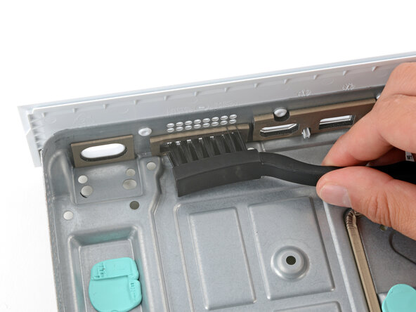

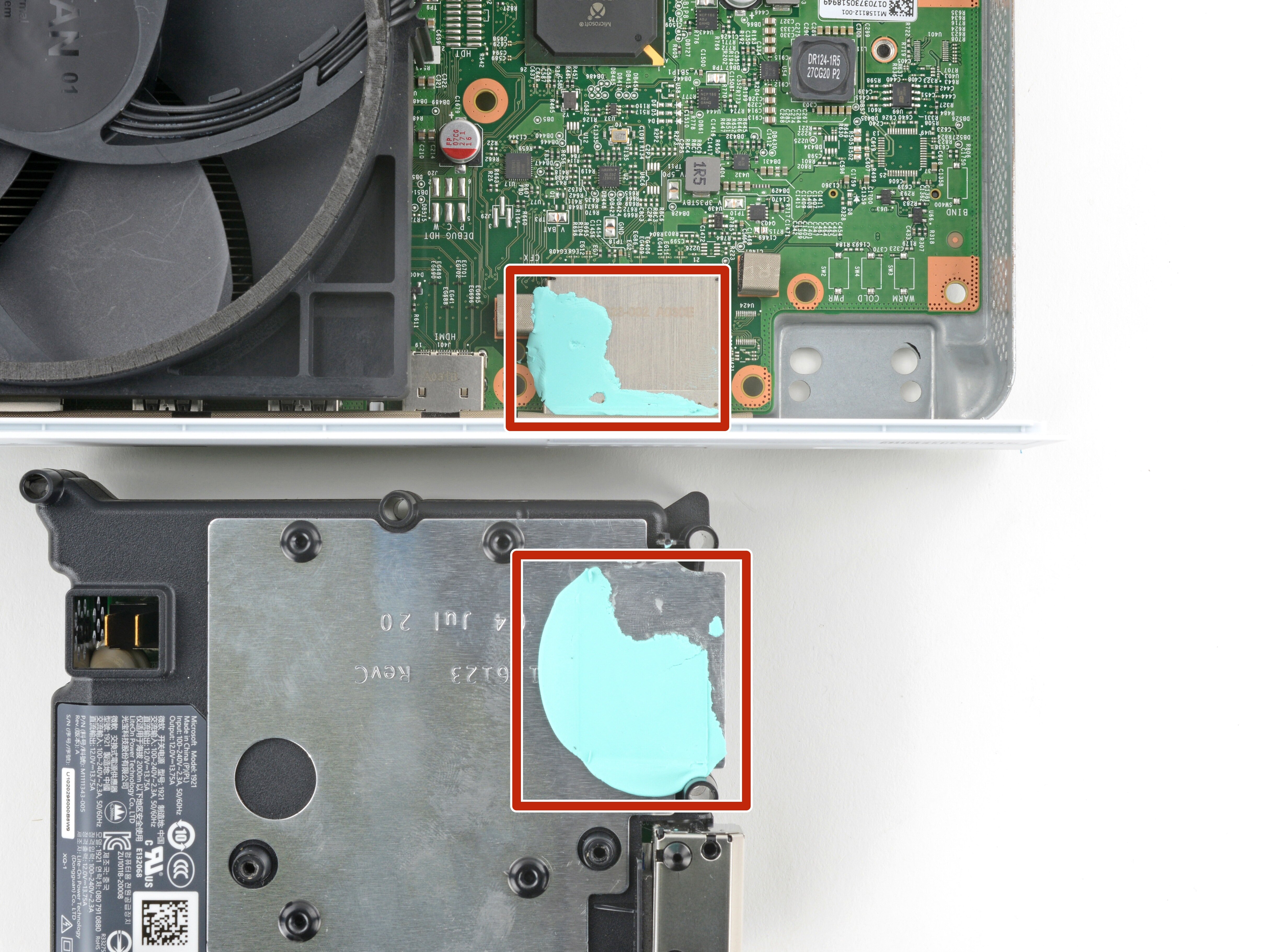

    1. How to Open and Clean an Xbox Series S, Clean the chassis: step 27, image 1 of 3 How to Open and Clean an Xbox Series S, Clean the chassis: step 27, image 2 of 3 How to Open and Clean an Xbox Series S, Clean the chassis: step 27, image 3 of 3
      • When cleaning the metal chassis, be very careful not to damage any thermal putty.
      • Use a cleaning brush or clean toothbrush to thoroughly clean all the port cutouts.
      • Lightly dip a clean cloth in soapy water and use it to remove any grime from the metal chassis.
      • For particularly tough spots, use a cotton swab and isopropyl to clean the area.
      • While your device is disassembled, thoroughly check all internal surfaces for dirt or grime and clean them accordingly.
      • If you damaged any of the thermal putty on the chassis, power supply, or motherboard, remove and replace the putty.
