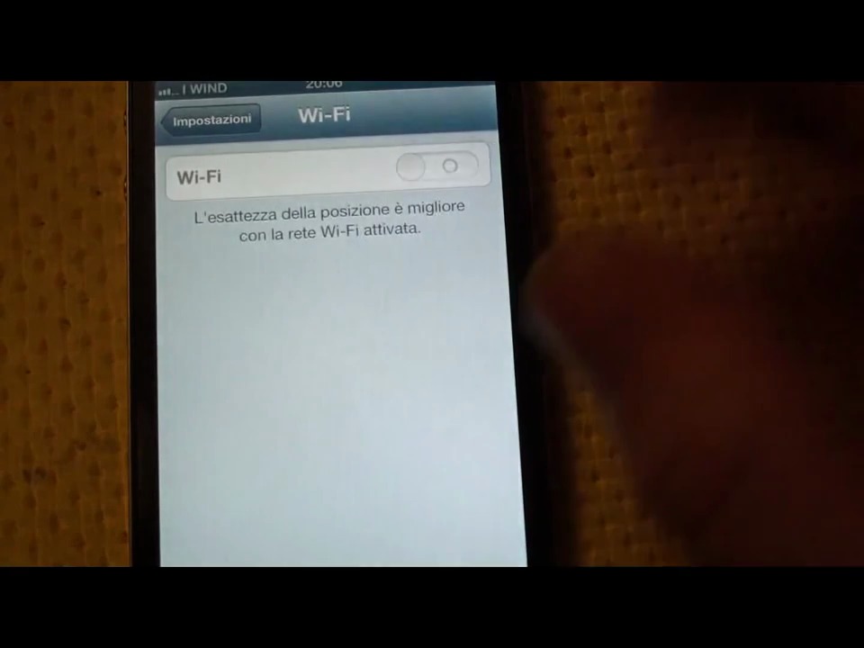

How to Fix iPhone 4S Wi-Fi Grayed Out

    1. How to Fix iPhone 4S Wi-Fi Grayed Out, How to Fix iPhone 4S Wi-Fi Grayed Out: step 24, image 1 of 3 How to Fix iPhone 4S Wi-Fi Grayed Out, How to Fix iPhone 4S Wi-Fi Grayed Out: step 24, image 2 of 3 How to Fix iPhone 4S Wi-Fi Grayed Out, How to Fix iPhone 4S Wi-Fi Grayed Out: step 24, image 3 of 3
      • Remove the adhesive protection on the Wi-Fi/bluetooth chip.
      • Now we can see the Murata SS1830010 chip.
      Ask FixBot
    2. How to Fix iPhone 4S Wi-Fi Grayed Out: step 25, image 1 of 3 How to Fix iPhone 4S Wi-Fi Grayed Out: step 25, image 2 of 3 How to Fix iPhone 4S Wi-Fi Grayed Out: step 25, image 3 of 3
      • Put the logic board in a PCB holder or small vise, to safely hold it while reflowing (it's going to get hot!).
      • Protect the logic board with Kapton tape that has good insulating and temperature characteristics (temperature range: −269 to +400 °C).
      Ask FixBot
    3. How to Fix iPhone 4S Wi-Fi Grayed Out: step 26, image 1 of 1
      • Now we need a hot air rework station with a small nozzle:
      • The nozzle's size must be 1/2 or 1/4 of the chip size.
      Ask FixBot
    4. How to Fix iPhone 4S Wi-Fi Grayed Out: step 27, image 1 of 3 How to Fix iPhone 4S Wi-Fi Grayed Out: step 27, image 2 of 3 How to Fix iPhone 4S Wi-Fi Grayed Out: step 27, image 3 of 3
      • Edit: the correct temperature is almost 180-200 °C because around the chip there is a little black protection that can go under the chip.
      • Set a low air flow: 1 or 2 (on a 1 to 7 scale).
      • Now, doing circular movement, you have to reflow for 4-5 minutes.
      • Be careful to reflow only the Wi-Fi chip and not any of the surrounding ICs or circuits.
      • After 5 minutes, gradually decrease the temperature from 200 to 0 °C.
      Ask FixBot
    5. How to Fix iPhone 4S Wi-Fi Grayed Out: step 28, image 1 of 1
      • After reflowing, wait ten minutes to allow the logic board to cool before handling it.
      • Remember to put on the protective sticker back on the Wi-Fi chip before reassembling the phone.
      Ask FixBot
    6. How to Fix iPhone 4S Wi-Fi Grayed Out: step 29, image 1 of 2 How to Fix iPhone 4S Wi-Fi Grayed Out: step 29, image 2 of 2
      • Here is the final result.
      Ask FixBot
    7. How to Fix iPhone 4S Wi-Fi Grayed Out: step 30, image 1 of 2 How to Fix iPhone 4S Wi-Fi Grayed Out: step 30, image 2 of 2
      • These are the pictures before and after the reflow:
      • In the first image, the Wi-Fi color is light grey (not working).
      • In the second image, the Wi-Fi color is dark grey (working).
      Ask FixBot

Mille grazie, Andrea! I completed the repair thanks to your awesome Guide. Could it be you forgot to describe disassembly of the camera + surroundings? I took it out, too.
However, thank you,
Alex
Alex Holzhey - Reply Share

Congratulations!!! It works perfectly!! Step by step following your guide and everything is fine.
Thank you
