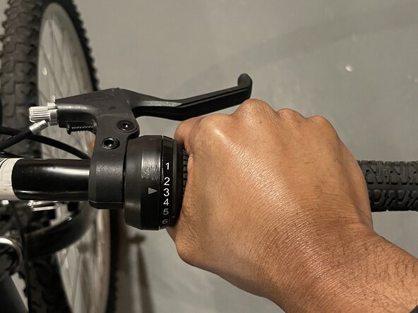

    • Shift the bicycle into a middle rear gear (about halfway across the cassette) to reduce chain tension.
    • To do this, slowly rotate the pedals forward while your right hand is positioned on the gear shifter. As the pedals are moving forward, use your right hand to shift to the middle gear.
    • "Middle gear" is where the chain hangs in between the smallest gear and the largest gear. It is best to shift to middle gear in this case so it is easier to operate on the stiff link.

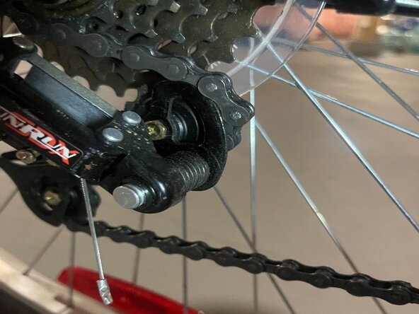

    • Identify the stiff link by watching for a section of chain that does not bend smoothly around the pulley wheels.
    • There should be a part of the chain that looks like a small lump or appears slightly raised.
    Ask FixBot
  5. How to Fix a Stiff Link in a Bicycle Chain: step 5, image 1 of 1
    • Stop rotating the pedals when the stiff link is positioned between the derailleur pulleys for easy access.

  6. How to Fix a Stiff Link in a Bicycle Chain: step 6, image 1 of 3 How to Fix a Stiff Link in a Bicycle Chain: step 6, image 2 of 3 How to Fix a Stiff Link in a Bicycle Chain: step 6, image 3 of 3
    • Wiggle the chain from side-to-side at the stiff link to loosen it slightly. Bend it a little toward the bicycle frame and then a little outwards of the bicycle frame and repeat. This motion helps loosen the tight joint that is preventing the link from bending smoothly.
    • Do not use too much force. After wiggling it a few times, check if the link is more loose.
