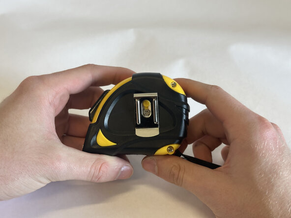

    1. How to Fix a Loose Tape Measure Lock, How to Fix a Loose Tape Measure Lock: step 1, image 1 of 3 How to Fix a Loose Tape Measure Lock, How to Fix a Loose Tape Measure Lock: step 1, image 2 of 3 How to Fix a Loose Tape Measure Lock, How to Fix a Loose Tape Measure Lock: step 1, image 3 of 3

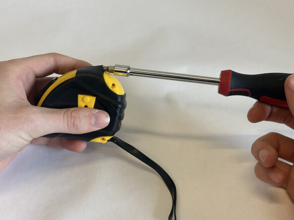

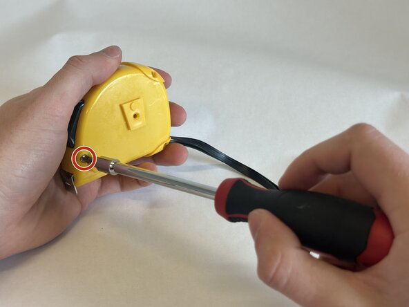

      • Remove the top and bottom screws from your tape measure using a Phillips head screwdriver.
      • The longer screw will be on the top, and the shorter screw will be on the bottom.

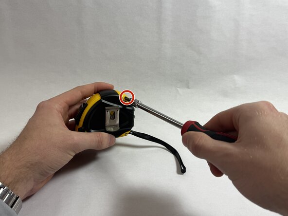

    2. How to Fix a Loose Tape Measure Lock: step 2, image 1 of 3 How to Fix a Loose Tape Measure Lock: step 2, image 2 of 3 How to Fix a Loose Tape Measure Lock: step 2, image 3 of 3
      • Remove the screw that fastens the clip with your Phillips head screwdriver and place the clip to the side.

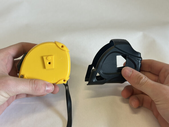

    3. How to Fix a Loose Tape Measure Lock: step 3, image 1 of 3 How to Fix a Loose Tape Measure Lock: step 3, image 2 of 3 How to Fix a Loose Tape Measure Lock: step 3, image 3 of 3
      • Loosen the rubber housing from its contact points with a spudger and remove it from the back of the tape measure.
      • This may require some force.

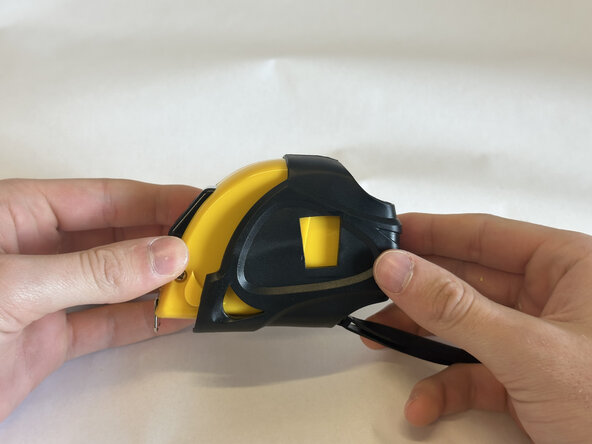

    4. How to Fix a Loose Tape Measure Lock: step 4, image 1 of 3 How to Fix a Loose Tape Measure Lock: step 4, image 2 of 3 How to Fix a Loose Tape Measure Lock: step 4, image 3 of 3
      • Remove the bottom screw with your Phillips head screwdriver.
      Ask FixBot

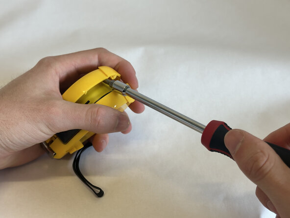

      • Pry open the yellow casing using your flathead screwdriver and lay down the halves so the internal components are facing up.

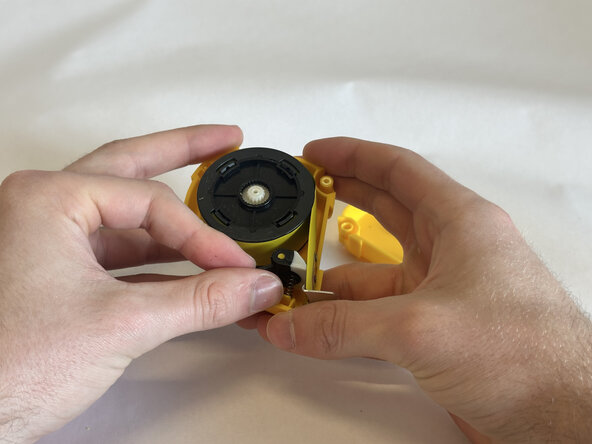

      • Carefully remove the button and tooth, and remove the spring from the tooth.
      • There may also be a small black piece that falls out; set it aside for later reassembly.
      Ask FixBot

      • Use a nail file or 220-400 grit sandpaper to roughen the surface of the pad using around 5 passes.
      • Too many passes can shorten the pad/tooth, worsening contact with the blade.
      Ask FixBot

      • Place the tooth back into its housing while also pressing the spring into place.
      Ask FixBot
    9. How to Fix a Loose Tape Measure Lock: step 9, image 1 of 3 How to Fix a Loose Tape Measure Lock: step 9, image 2 of 3 How to Fix a Loose Tape Measure Lock: step 9, image 3 of 3
      • Apply pressure to the tooth and press the button back into place.
      • When leaving it untouched, the tooth should be applying pressure to the blade.
      Ask FixBot
    10. How to Fix a Loose Tape Measure Lock: step 10, image 1 of 3 How to Fix a Loose Tape Measure Lock: step 10, image 2 of 3 How to Fix a Loose Tape Measure Lock: step 10, image 3 of 3
      • Slightly retract the tape while holding the internal components in place.
      • Press the small remaining black piece back into place.

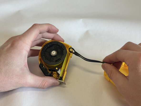

      • Reattach the band to its loop, then place the empty shell of the tape measure on top of the side housing the mechanism.
      Ask FixBot

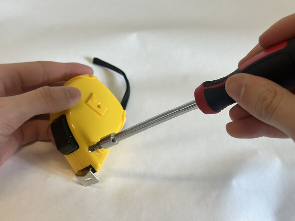

      • Screw in the front-bottom screw using your Phillips head screwdriver, recalling the order in which you removed them.
      Ask FixBot

      • Reinsert the larger of the two remaining screws in the top hole.
      Ask FixBot
    16. How to Fix a Loose Tape Measure Lock: step 16, image 1 of 3 How to Fix a Loose Tape Measure Lock: step 16, image 2 of 3 How to Fix a Loose Tape Measure Lock: step 16, image 3 of 3
      • Reinsert the remaining screw in the bottom hole, and you have a repaired tape measure!
