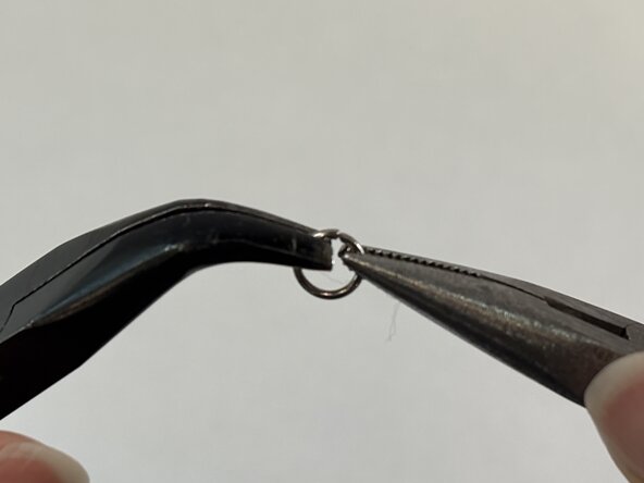

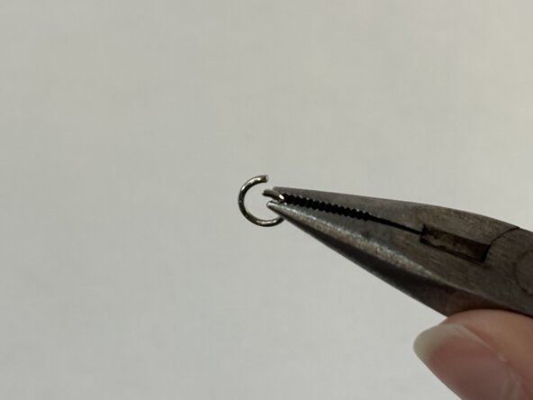

    • Using your bent nose pliers, pick up a closed jump ring.
    • Using your needle nose pliers, bend one end of the ring towards yourself.
    • Repeat above steps until you have 2-3 open jump rings.
