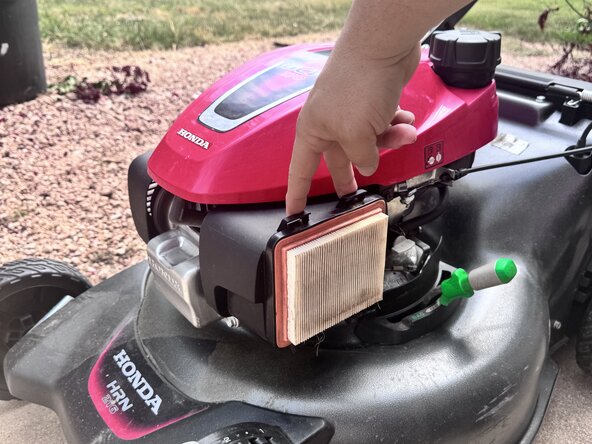

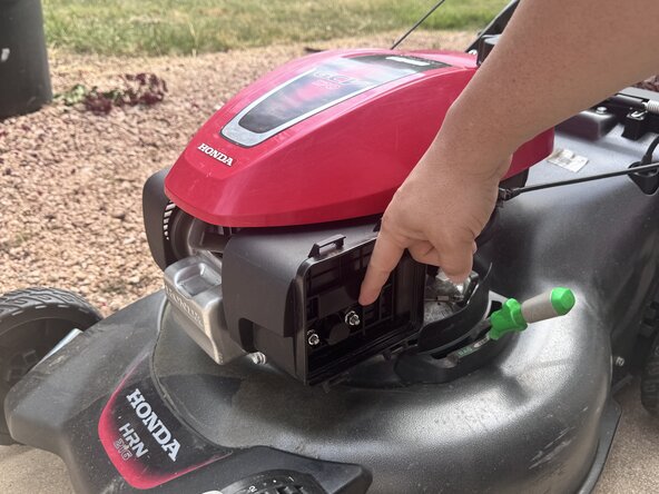

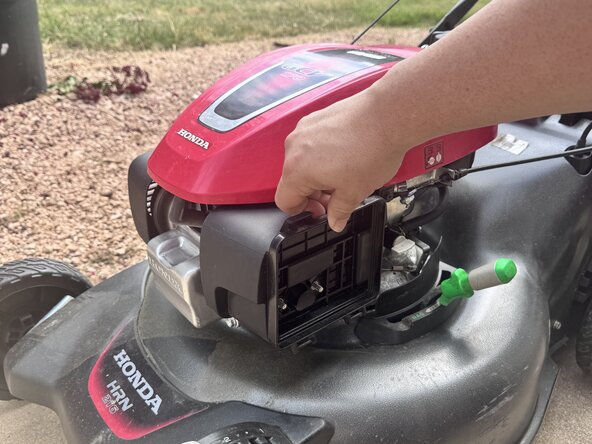

      • Press down on the two retaining clips located at the top of the air filter housing.
      • While holding the clips down, pull them outward to release the cover.
      • Allow the air filter cover to swing downward.
      • Lift the cover off the lower pivot tabs to remove it.
      • Remove the filter from the housing.
      • If the filter appears dirty, clogged, or worn, replace it now to help maintain proper engine performance.

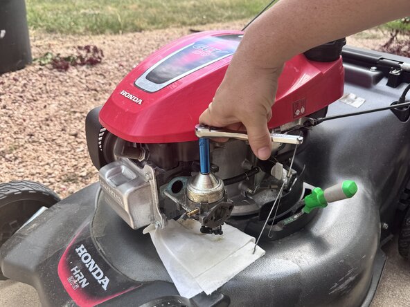

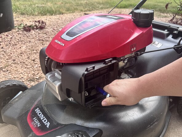

      • Remove the two 10mm nuts securing the air filter housing to the side of the mower.
      • These bolts go all the way through the carb so only remove the nuts on the ends.
      • Slide the housing off the studs, taking note of the location of the small hose attached to the air filter housing going underneath the red cover.
      • Remember the hose location, as it will need to be pushed back into place on the mower when reinstalling the filter housing; it has no clip holding it in place only friction.

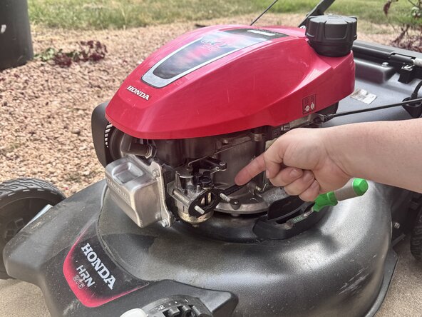

    4. How to Clean a Honda GCV170 Carburetor: step 4, image 1 of 3 How to Clean a Honda GCV170 Carburetor: step 4, image 2 of 3 How to Clean a Honda GCV170 Carburetor: step 4, image 3 of 3
      • Slide the carburetor straight off the mounting posts.
      • Once the carburetor is free from the posts, carefully rotate it 45 degrees clockwise to gain access to the throttle linkage.
      • Remove the throttle rod and spring from the carburetor.
      • Pay close attention to how the throttle rod and spring are installed before removal. The rod installs in the hole closest to the brass post, while the spring installs in the hole farther away from the brass post. Remembering this orientation will make reinstallation much easier.

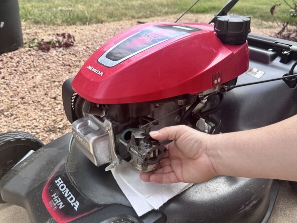

    5. How to Clean a Honda GCV170 Carburetor: step 5, image 1 of 3 How to Clean a Honda GCV170 Carburetor: step 5, image 2 of 3 How to Clean a Honda GCV170 Carburetor: step 5, image 3 of 3
      • With the carburetor removed from the mower, the next step is to remove the float bowl.
      • Locate the 10mm bolt on the bottom of the carburetor and remove it using a 10mm socket or wrench.
      • To make removing the bolt easier, flip the carburetor upside down and carefully slide it back onto the mounting shafts where it was originally installed. This provides additional stability and leverage, making it easier to loosen the 10mm bolt without putting stress on the carburetor.
      • Once the bolt is removed, the float bowl can be separated from the bottom of the carburetor. Be careful, as there may still be a small amount of fuel inside the bowl. Have a paper towel or rag nearby to catch any remaining fuel and keep your work area clean.

    6. How to Clean a Honda GCV170 Carburetor: step 6, image 1 of 3 How to Clean a Honda GCV170 Carburetor: step 6, image 2 of 3 How to Clean a Honda GCV170 Carburetor: step 6, image 3 of 3
      • With the 10mm bolt removed, carefully remove the float bowl from the bottom of the carburetor. The bowl should lift straight up and off with minimal effort.
      • Old fuel can leave behind varnish/residue inside the float bowl. Use a clean sponge to scrub the inside of the bowl until all visible buildup has been removed.
      • This is also an excellent opportunity to clean the inside passages of the carburetor. Spray brake cleaner into the carburetor openings and crevices to help remove fuel deposits. Follow up with compressed air to clear out any debris and ensure the small fuel passages are open.

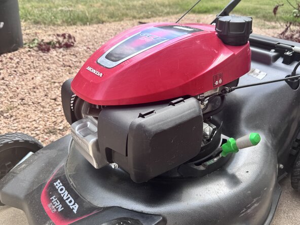

      • Reassembly is completed by following the removal steps in reverse order. Reinstall the float bowl onto the bottom of the carburetor and secure it using the 10mm bolt.
      • Flip the carburetor back into position and reconnect the throttle rod and spring.
      • Slide the carburetor back onto the mounting posts, reconnect the fuel line, and reinstall the fuel line clip. Once the fuel line is secure, turn the fuel shutoff valve back on by rotating the grey lever back to the horizontal position.
      • Reinstall the air filter housing onto the mower and secure it using the two 10mm nuts. Make sure the hose underneath the red cover is properly positioned.
      • Finally, reinstall the air filter and snap the air filter cover back into place.
      • Before starting the mower, double-check that all bolts, clips, hoses, and covers are properly installed.
