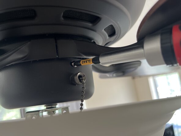

    3. How to Balance a Wobbly Ceiling Fan: step 3, image 1 of 2 How to Balance a Wobbly Ceiling Fan: step 3, image 2 of 2
      • Insert a screwdriver through the opening and tighten each fan blade screw.
      • Do not overtighten the screws.
      • Rotate the fan blades with your hand to access and tighten the other blade screws.

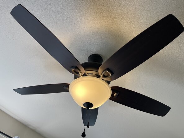

    5. How to Balance a Wobbly Ceiling Fan: step 5, image 1 of 1
      • Turn the fan on.
      • If it isn't balanced to your liking, you will need to use a balancing kit.
      • Note which fan speed creates the most noticeable wobble, usually the highest setting.
      Ask FixBot

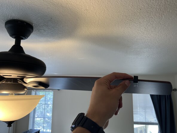

    6. How to Balance a Wobbly Ceiling Fan: step 6, image 1 of 2 How to Balance a Wobbly Ceiling Fan: step 6, image 2 of 2
      • Place a clip from the balancing kit in the middle of a random blade and turn the fan on. Take note of the difference in wobble.
      • Move the clip to the next blade over and turn the fan on again. Continue this process until you've tried the clip on each blade and found the one that improves the wobble the most.
      • For now, we are just putting the clip in the middle of the blades.

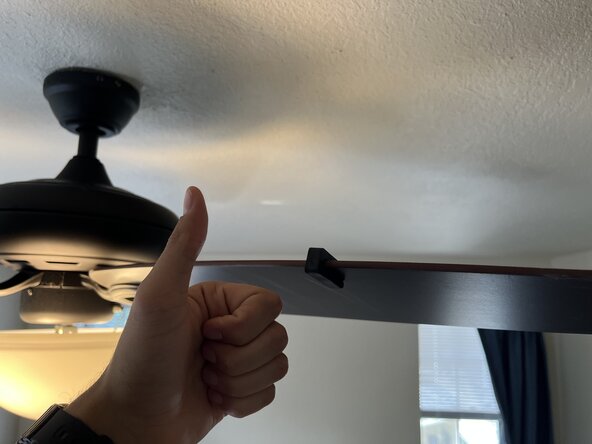

    7. How to Balance a Wobbly Ceiling Fan: step 7, image 1 of 3 How to Balance a Wobbly Ceiling Fan: step 7, image 2 of 3 How to Balance a Wobbly Ceiling Fan: step 7, image 3 of 3
      • On the fan blade where the clip improves the wobble the most, move the clip slightly left or right.
      • Turn on the fan and repeat this process until you find the “sweet spot” where the wobble is minimized.

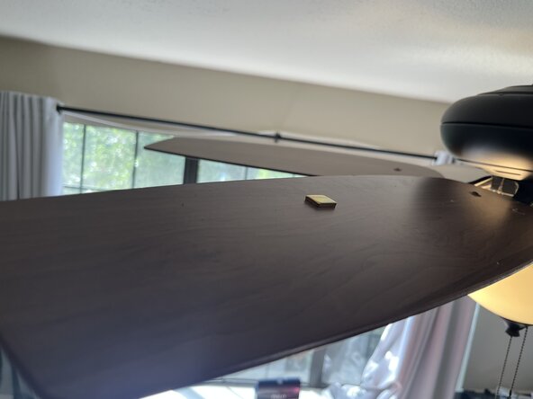

    8. How to Balance a Wobbly Ceiling Fan: step 8, image 1 of 2 How to Balance a Wobbly Ceiling Fan: step 8, image 2 of 2
      • Put a couple droplets of superglue on the weight.
      • Balancing weights come with an adhesive built-in that you can use instead, superglue is just my recommendation.
      Ask FixBot
    9. How to Balance a Wobbly Ceiling Fan: step 9, image 1 of 2 How to Balance a Wobbly Ceiling Fan: step 9, image 2 of 2
      • If there is a lot of dust on the blade, wipe it off first to help the weight stick properly.
      • Place the weight with the superglue right in front of the clip.
      • Take the balancing clip off and allow a few minutes for the glue/adhesive to dry.
