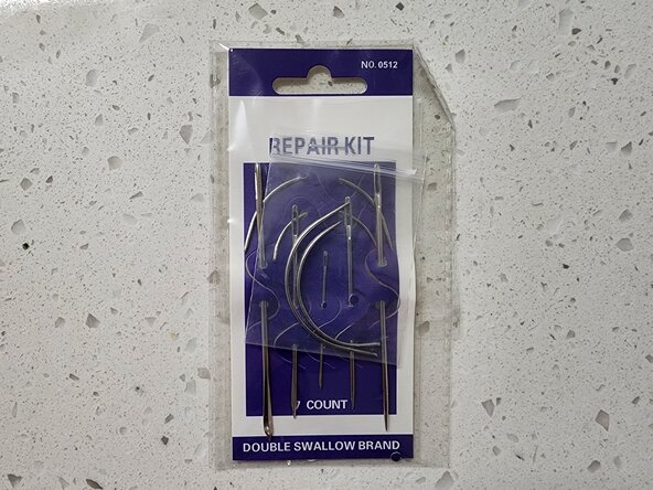

    3. How To Repair A Cat Torn Polyester Couch: step 3, image 1 of 1
      • Insert the polyester, or nylon bonded, thread through your heavy-duty upholstery needle.
      Ask FixBot

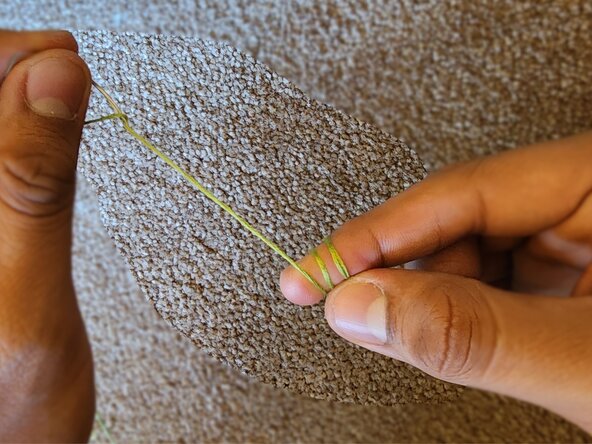

    4. How To Repair A Cat Torn Polyester Couch: step 4, image 1 of 1
      • To knot your thread, first loop the thread around your index finger at least three times.
      • Pinch the thread with your thumb, and slowly roll the thread off of your fingertip with your thumb
      Ask FixBot
