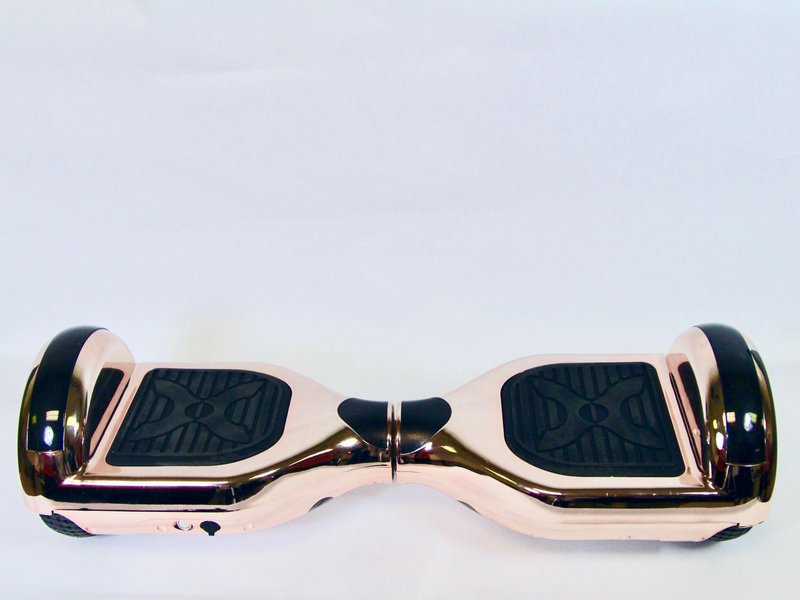

When the Hover-1 Matrix is turned on, the LED light in the board will glow to show you that it is on. It is an important part of the hoverboard because it lights up the path in front of you. If you have a broken LED it could lead to injuries.
If you have already tried other troubleshooting methods, and have not found a solution, this guide will teach you how to replace the LED light in your Hover-1 Matrix.
