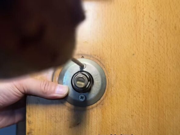

    1. House Door Lock Cylinder Replacement, Lock Cylinder: step 1, image 1 of 1
      • Push out the retaining pin from the inside and remove the door knob.
