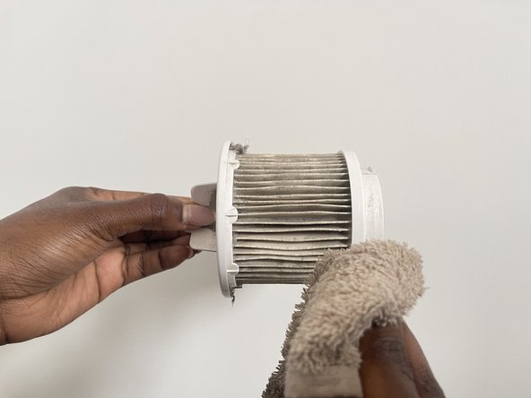

  5. Hoover Whirlwind Bagless SE71WRO1 Filter Replacement: step 5, image 1 of 3 Hoover Whirlwind Bagless SE71WRO1 Filter Replacement: step 5, image 2 of 3 Hoover Whirlwind Bagless SE71WRO1 Filter Replacement: step 5, image 3 of 3
    • Before installing the new filter, clean the area where the filter sits.
    • Use a clean cloth or a small brush to remove any dust or debris.
    • Get in between the spaces of the filter as well.
    • This ensures the optimal performance of the new filter.
