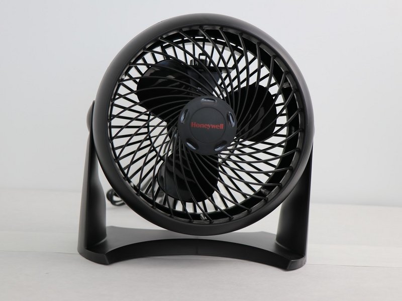

If your Honeywell Turboforce Air Circulator is not working when you turn the device on, you may have a dead motor which needs replacing. Our guide will help show you how to properly remove the dead motor.

    1. Honeywell Turboforce Motor Replacement, Motor: step 1, image 1 of 3 Honeywell Turboforce Motor Replacement, Motor: step 1, image 2 of 3 Honeywell Turboforce Motor Replacement, Motor: step 1, image 3 of 3
      • Using a Phillips #1 screwdriver, remove the six 15mm screws on the outer ring of the back of the fan holding the frame together.
      • The screw channel is long and it is recommended to use a screwdriver with a long shaft or a screwdriver with a skinnier handle.
      Ask FixBot
    2. Honeywell Turboforce Motor Replacement: step 2, image 1 of 3 Honeywell Turboforce Motor Replacement: step 2, image 2 of 3 Honeywell Turboforce Motor Replacement: step 2, image 3 of 3
      • Pry apart the blade cover from the body of the fan to access the inside.
      Ask FixBot
    3. Honeywell Turboforce Motor Replacement: step 3, image 1 of 2 Honeywell Turboforce Motor Replacement: step 3, image 2 of 2
      • Remove the two 36mm screws on the metal plate behind the blades using the Phillips #1 screwdriver.
      Ask FixBot
    4. Honeywell Turboforce Motor Replacement: step 4, image 1 of 2 Honeywell Turboforce Motor Replacement: step 4, image 2 of 2
      • Carefully pull the motor forward out of its resting position and tilt it forward revealing the back of the motor.
      • Beware of the wires attached to the back of the motor.
      Ask FixBot
    5. Honeywell Turboforce Motor Replacement: step 5, image 1 of 3 Honeywell Turboforce Motor Replacement: step 5, image 2 of 3 Honeywell Turboforce Motor Replacement: step 5, image 3 of 3
      • Using the Phillips #1 screwdriver, remove the two 37mm screws on the back of the motor.
      • Beware that there is a nut holding the screw in place on the opposite side of the motor.
      • Beware once the screw is removed the metal brace where the screws are located will come off.
      Ask FixBot
    6. Honeywell Turboforce Motor Replacement: step 6, image 1 of 2 Honeywell Turboforce Motor Replacement: step 6, image 2 of 2
      • Carefully remove the circular motor from the square holder.
      • The fan blades will still be connected to the circular motor.
      Ask FixBot
    7. Honeywell Turboforce Motor Replacement: step 7, image 1 of 3 Honeywell Turboforce Motor Replacement: step 7, image 2 of 3 Honeywell Turboforce Motor Replacement: step 7, image 3 of 3
      • Remove the felt washer, metal washer, and the rubber stopper from the axle.
      Ask FixBot
    8. Honeywell Turboforce Motor Replacement: step 8, image 1 of 1
      • Remove the motor and replace it with the new part.
      • Consider using a lubricant to insert the new motor.
      Ask FixBot
