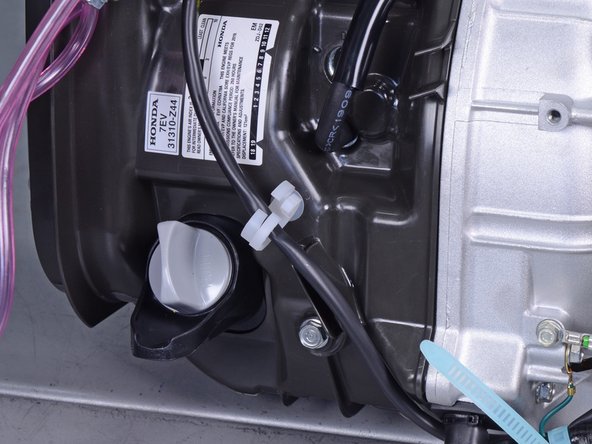

    1. Honda EU2200IT A2 Stator Replacement, Drain the engine oil: step 6, image 1 of 2 Honda EU2200IT A2 Stator Replacement, Drain the engine oil: step 6, image 2 of 2
      • Unscrew and remove the oil filler cap.
      Ask FixBot
    2. Honda EU2200IT A2 Stator Replacement: step 7, image 1 of 2 Honda EU2200IT A2 Stator Replacement: step 7, image 2 of 2
      • Place an oil pan below the fill port to catch the engine oil.
      • Carefully tilt the generator towards the oil pan to drain the oil.
      Ask FixBot
    3. Honda EU2200IT A2 Stator Replacement: step 8, image 1 of 1
      • During reassembly, be sure to refill the engine oil:
      • If you recently resealed the crankcase cover with liquid sealant, wait at least 20 minutes before adding oil.
      • Use SAE 10W-30 oil, up to 0.46 US quarts.
      • Add oil until the dipstick is almost completely submerged.

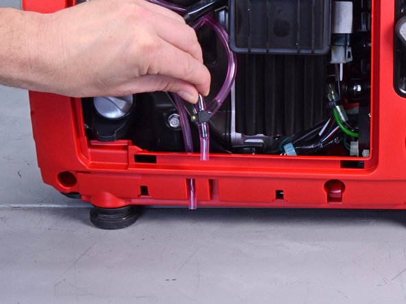

    1. Honda EU2200IT A2 Stator Replacement, Drain the carburetor fuel bowl: step 9, image 1 of 1
      • Place a container below the drain tube to catch the excess fuel.

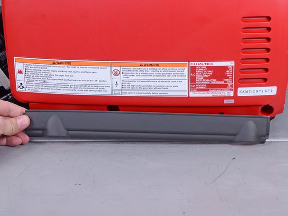

    3. Honda EU2200IT A2 Stator Replacement, Remove the left cover: step 15, image 1 of 3 Honda EU2200IT A2 Stator Replacement, Remove the left cover: step 15, image 2 of 3 Honda EU2200IT A2 Stator Replacement, Remove the left cover: step 15, image 3 of 3
      • Remove the lower gray plates from both sides of the generator.
      • During reassembly, be sure to reinstall the gray plate with the air vent cutout onto the right (access-side) cover.
      Ask FixBot

    6. Honda EU2200IT A2 Stator Replacement, Remove the right cover: step 18, image 1 of 3 Honda EU2200IT A2 Stator Replacement, Remove the right cover: step 18, image 2 of 3 Honda EU2200IT A2 Stator Replacement, Remove the right cover: step 18, image 3 of 3
      • Slide the vent and drain tubes out of their cover ports along the bottom of the right cover.

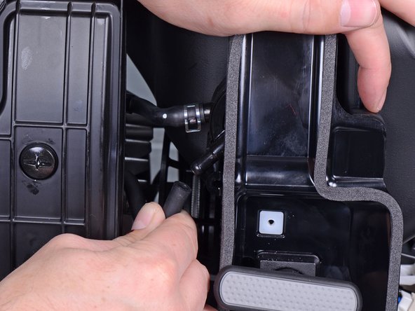

    4. Honda EU2200IT A2 Stator Replacement: step 25, image 1 of 2 Honda EU2200IT A2 Stator Replacement: step 25, image 2 of 2
      • Pull and disconnect the engine stop switch connector from its socket.
      Ask FixBot

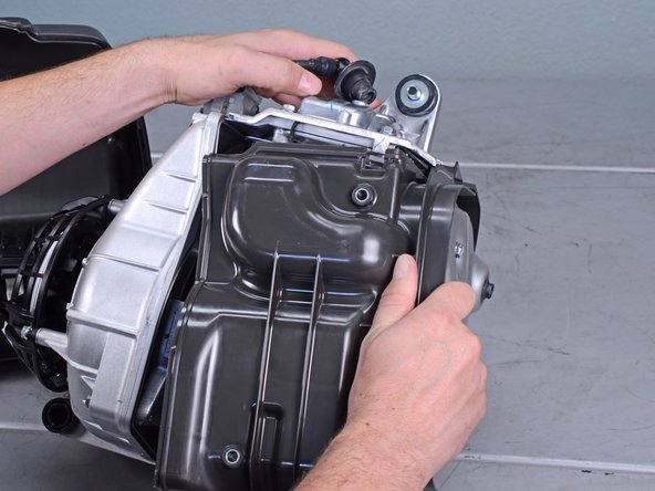

    6. Honda EU2200IT A2 Stator Replacement: step 38, image 1 of 2 Honda EU2200IT A2 Stator Replacement: step 38, image 2 of 2

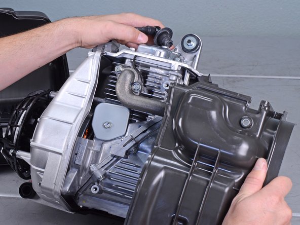

      • Begin separating the left shroud from the engine assembly by pulling it away from the assembly.
      • The shroud sits in a groove on the engine assembly and may take some force to pull out.
      Ask FixBot
    7. Honda EU2200IT A2 Stator Replacement: step 39, image 1 of 3 Honda EU2200IT A2 Stator Replacement: step 39, image 2 of 3 Honda EU2200IT A2 Stator Replacement: step 39, image 3 of 3
      • Pull along the edge of the shroud until you separate the shroud from the engine assembly.
      • Remove the shroud.

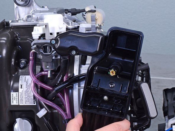

    8. Honda EU2200IT A2 Stator Replacement, Remove the air filter housing: step 40, image 1 of 2 Honda EU2200IT A2 Stator Replacement, Remove the air filter housing: step 40, image 2 of 2
      • Remove the Phillips screw securing the filter cover.
      • During reassembly, be sure to tighten the screw to at least 1.7 ft-lb to prevent it from loosening during operation.
      • Remove the filter cover.

    10. Honda EU2200IT A2 Stator Replacement: step 42, image 1 of 2 Honda EU2200IT A2 Stator Replacement: step 42, image 2 of 2
      • Disconnect the breather tube from the air cleaner housing.
      Ask FixBot
    11. Honda EU2200IT A2 Stator Replacement: step 43, image 1 of 1
      • Remove the following fasteners securing the housing:
      • Two 8 mm nuts
      • During reassembly, tighten these to 3.6 ft-lb.
      • One 8 mm bolt
      Ask FixBot
    12. Honda EU2200IT A2 Stator Replacement: step 44, image 1 of 2 Honda EU2200IT A2 Stator Replacement: step 44, image 2 of 2
      • Remove the air filter housing.
      Ask FixBot
    13. Honda EU2200IT A2 Stator Replacement: step 45, image 1 of 1
      • During reassembly, replace the air intake gasket if it shows signs of wear.
      Ask FixBot
    14. Honda EU2200IT A2 Stator Replacement: step 46, image 1 of 1
      • During reassembly, use this photo as a reference for how to route the hoses.
      Ask FixBot

    24. Honda EU2200IT A2 Stator Replacement: step 56, image 1 of 2 Honda EU2200IT A2 Stator Replacement: step 56, image 2 of 2
      • Begin separating the right shroud from the engine assembly by pulling it away from the assembly.
      Ask FixBot
    25. Honda EU2200IT A2 Stator Replacement: step 57, image 1 of 3 Honda EU2200IT A2 Stator Replacement: step 57, image 2 of 3 Honda EU2200IT A2 Stator Replacement: step 57, image 3 of 3
      • Pull the shroud away along the edge. Use a flathead screwdriver to pry it out of the engine assembly groove.
      Ask FixBot
    26. Honda EU2200IT A2 Stator Replacement: step 58, image 1 of 2 Honda EU2200IT A2 Stator Replacement: step 58, image 2 of 2
      • Remove the right shroud from the engine assembly.

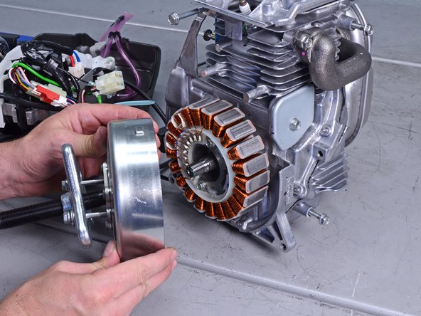

    15. Honda EU2200IT A2 Stator Replacement: step 73, image 1 of 2 Honda EU2200IT A2 Stator Replacement: step 73, image 2 of 2
      • Attach a flywheel puller to the rotor and attach the collar bolts to the marked holes.
      • Use the flywheel puller to loosen the rotor from the axle.
      Ask FixBot
    16. Honda EU2200IT A2 Stator Replacement: step 74, image 1 of 3 Honda EU2200IT A2 Stator Replacement: step 74, image 2 of 3 Honda EU2200IT A2 Stator Replacement: step 74, image 3 of 3
      • Remove the rotor.
      • Reassembly tip: When you replace the rotor, make sure the rotor aligns to the key on the shaft.
      Ask FixBot
