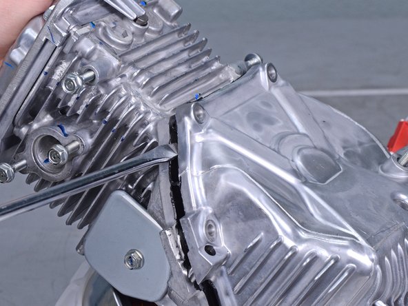

  69. Honda EU2200IT A2 Oil Level Switch Replacement: step 69, image 1 of 3 Honda EU2200IT A2 Oil Level Switch Replacement: step 69, image 2 of 3 Honda EU2200IT A2 Oil Level Switch Replacement: step 69, image 3 of 3
    • The crankcase cover is sealed with liquid sealant and must be pried apart.
    • Be ready to contain any residual engine oil that may spill from the crankcase.
    • Insert a large flathead screwdriver or pry bar into the crankcase seam and pry to loosen the crankcase cover.
    • Do not use too much force, or you may gouge the mating surface.
    • Pry along the entire crankcase perimeter until you fully loosen the crankcase cover.

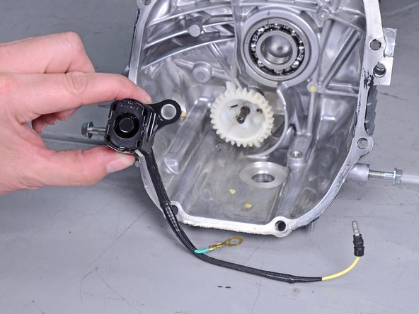

  73. Honda EU2200IT A2 Oil Level Switch Replacement: step 73, image 1 of 3 Honda EU2200IT A2 Oil Level Switch Replacement: step 73, image 2 of 3 Honda EU2200IT A2 Oil Level Switch Replacement: step 73, image 3 of 3
    • Thread the sensor cable through the port and remove the sensor.
    • Be sure to check if your replacement sensor has an O-ring pre-installed on the sensor's mating surface. If it doesn't, transfer the O-ring over.
