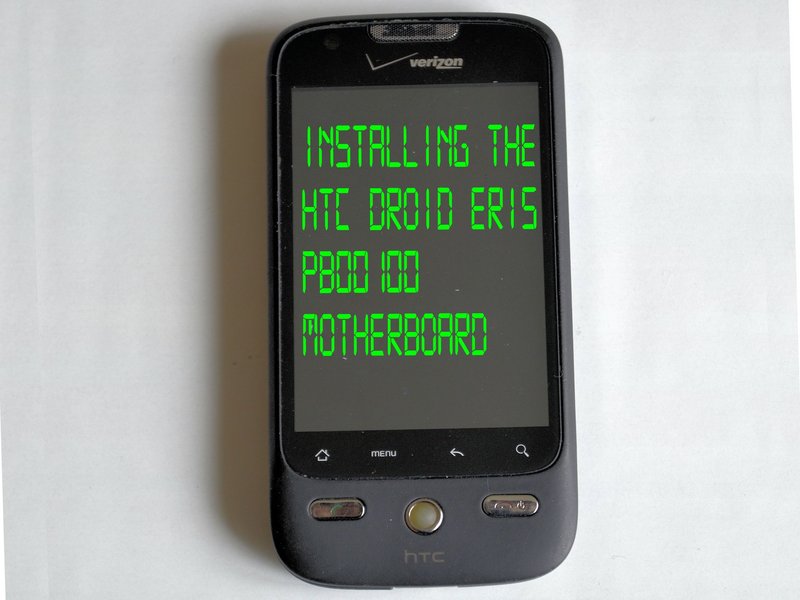

HTC Droid Eris Motherboard Replacement
Introduction
Go to step 1 ↓
This guide will teach you how to replace/install the motherboard.
