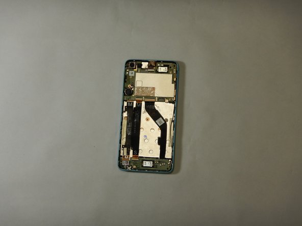

  5. HTC Desire 826 Motherboard Replacement, Motherboard: step 5, image 1 of 2 HTC Desire 826 Motherboard Replacement, Motherboard: step 5, image 2 of 2
    • Remove the three 4.0 mm T5 Torx screws connected to the motherboard.
  6. HTC Desire 826 Motherboard Replacement: step 6, image 1 of 2 HTC Desire 826 Motherboard Replacement: step 6, image 2 of 2
    • Disconnect the ribbon cable from the motherboard by flipping up the locking tab with a spudger and pulling out the cable with your fingers.
    • Lift the motherboard out of the frame, using a spudger to help pick up one of the edges.
