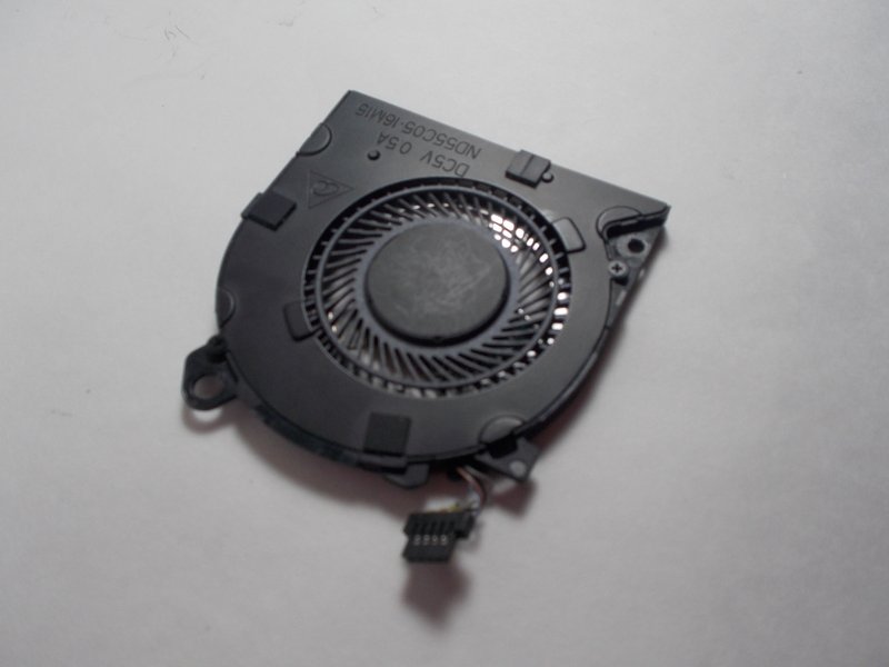

    1. HP Spectre x360 13-ac023dx Fan  Replacement, Fan: step 4, image 1 of 1
      • Locate the Cooling Fan in the device.
      Ask FixBot
    2. HP Spectre x360 13-ac023dx Fan  Replacement: step 5, image 1 of 2 HP Spectre x360 13-ac023dx Fan  Replacement: step 5, image 2 of 2
      • Use the Phillips #000 screwdriver to remove the 3mm screws holding the fan in place.
      • Remove the wires connecting to the motherboard, using the iFixit opening tool.
      • The iFixit Opening Tool is not required, but recommended
      Ask FixBot
    3. HP Spectre x360 13-ac023dx Fan  Replacement: step 6, image 1 of 1
      • Remove the Cooling Fan.
      Ask FixBot
