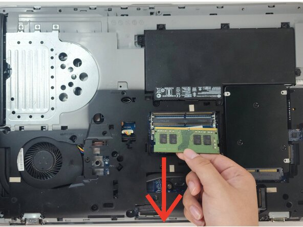

    • Use a Phillips screwdriver to remove the 10 screws from the bottom of the laptop.
    • Remove the cover and set it aside.

    • Press on the tabs on the side of the RAM, these hold it down.
    • Once the RAM is no longer held by the brackets, pull it out.
    • Align the tabs, insert the RAM card, and press it down until you feel it click.
