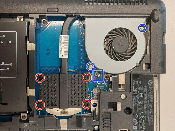

    1. HP ProBook 650 G1 Thermal Paste Replacement, Opening the back panel: step 1, image 1 of 3 HP ProBook 650 G1 Thermal Paste Replacement, Opening the back panel: step 1, image 2 of 3 HP ProBook 650 G1 Thermal Paste Replacement, Opening the back panel: step 1, image 3 of 3
      • Unlock and remove the back panel and battery.
      • Disconnect, unscrew and remove the fan.
      • Unscrew the 4 screws holding the CPU heatsink.

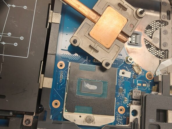

    2. HP ProBook 650 G1 Thermal Paste Replacement, Changing the thermal paste: step 2, image 1 of 3 HP ProBook 650 G1 Thermal Paste Replacement, Changing the thermal paste: step 2, image 2 of 3 HP ProBook 650 G1 Thermal Paste Replacement, Changing the thermal paste: step 2, image 3 of 3
      • Clean the old thermal paste from both the cooler and the CPU.
      • Use isopropyl alcohol and cotton swabs or paper towel, but be careful not to press too hard on the CPU.
      • It's also recommended to use compressed air to remove any dust in the laptop and the fan.
      • Here you can upgrade the CPU if needed.
      • Use only enough thermal paste to cover a portion of the pad. Use a spreader if you have one.
      • The thermal paste will apply evenly after you tighten the heatsink.
      • Place the heatsink back into the unit carefully and tighten the screws in an "X" pattern to ensure even pressure. Don't forget to plug in the fan.
