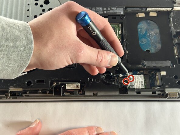

    1. HP ProBook 640 G3 Screen Replacement, Wi-Fi Card: step 6, image 1 of 1
      • Use a Phillips screwdriver to remove the two 6 mm-long screws on the metal piece holding down the Wi-Fi card. One screw will be on top, and the other will be just next to the wires holding it in.
      • Carefully remove the little metal piece from where it was resting.
      • The metal piece is small and non-magnetic. Leave in clear line of sight to avoid losing it.
      Ask FixBot
    2. HP ProBook 640 G3 Screen Replacement: step 7, image 1 of 1
      • The only thing holding the Wi-Fi card will be two small wires. These can easily be taken off by the use of your hands or helpful tweezers.
      • Gently remove the card by pulling it out of its slot.
      Ask FixBot
