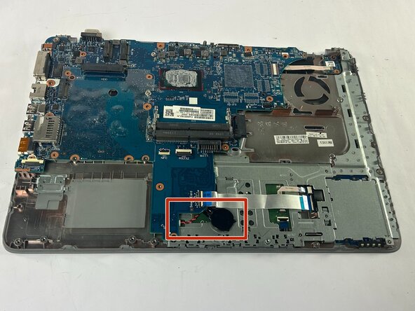

  12. HP ProBook 640 G3 Motherboard Battery Replacement, Motherboard Battery: step 12, image 1 of 2 HP ProBook 640 G3 Motherboard Battery Replacement, Motherboard Battery: step 12, image 2 of 2
    • Locate the motherboard battery.
    • The mother board itself doesn't need to be removed for the battery to be replaced.

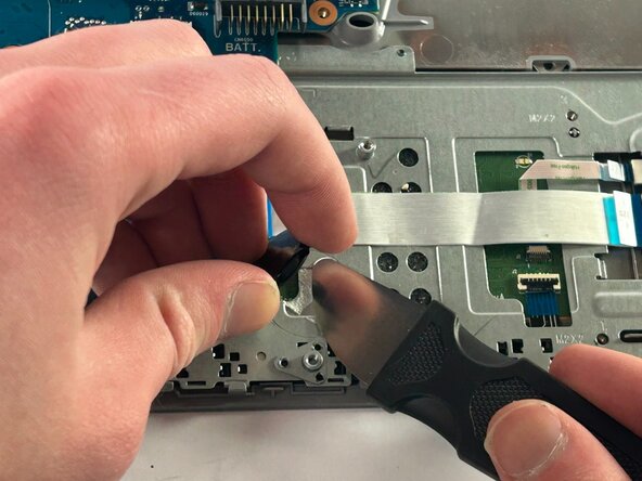

  14. HP ProBook 640 G3 Motherboard Battery Replacement: step 14, image 1 of 2 HP ProBook 640 G3 Motherboard Battery Replacement: step 14, image 2 of 2
    • Using your hands or a set of tweezers, carefully disconnect the battery from its motherboard port.
    • This wire is fragile, so take care in handling it.
